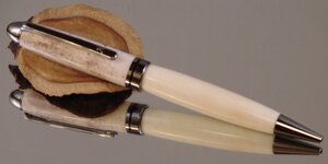

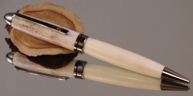

An antler pen with the bark showing is a tricky drill. Its hard drilling a straight hole into a curved piece of antler. The only way to have the bark showing is to drill offset from center on straight piece or "closer" to the bend on a curved piece. When it turns out nice it really gives the pen its own personallity. What I was told when I first started turning the material is practice, practice, and more practice. It polishes well and lasts long. You can find solid ivory and of course the marrow filled bone. Heres a pic using both for the different barrels.
