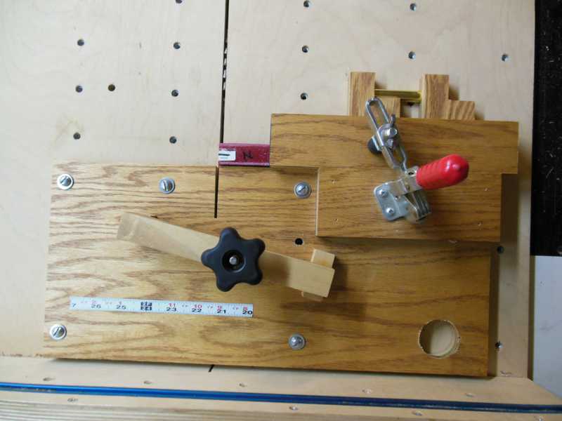

I just toss mine on the (cheap, small) bandsaw with a nicely squared sled. Takes all of 2 seconds, plus 15 seconds of sanding/filing to remove burrs.
