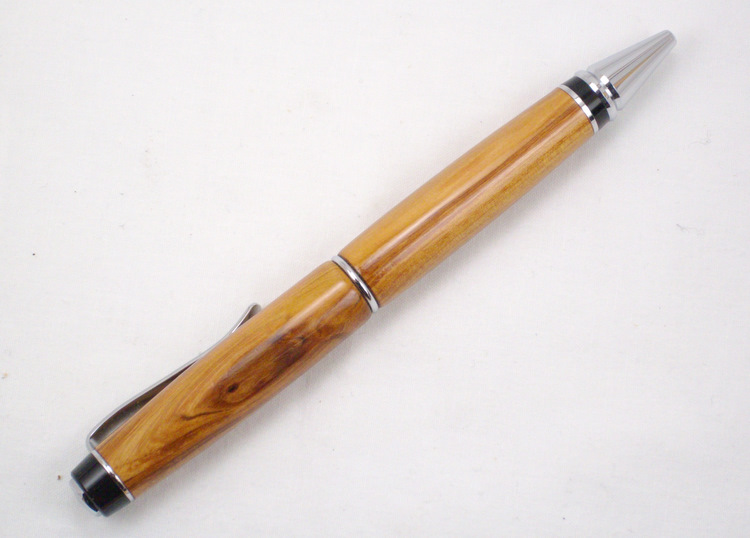

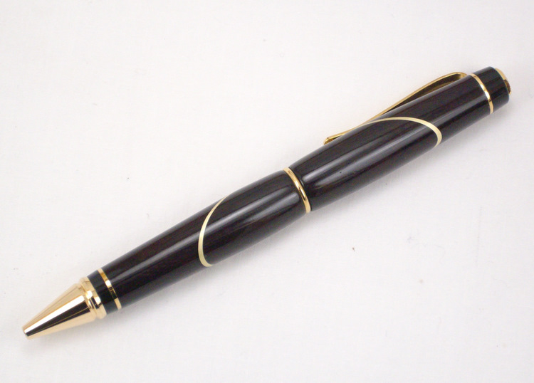

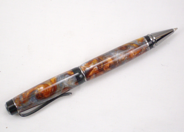

I think everyone who makes any number of cigars sooner or later gets the bushings switched for the barrels.
If it is a really pretty piece of wood or acrylic, all is not lost. You can modify the pen by gluing a piece on the top (shorter) barrel to make up for the clunky standard centerband and turn it down to the lower barrel (smaller) bushing, then turn the lower barrel down to the correct (smaller bushing), then put the pen together without the standard centerband. That's what I did with the acrylic pen shown here.
The other two, I left the centerband out on purpose.
I do turn the flange off the standard centerband and insert it in the upper barrel to help center the transmission - I'm not sure how necessary it is to do that.
