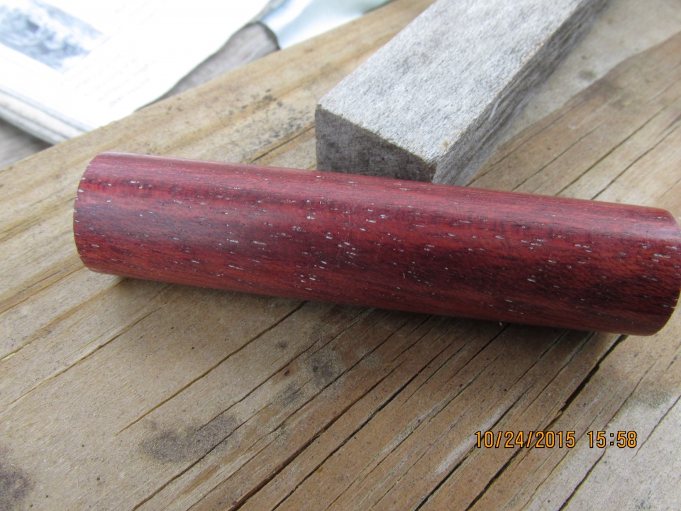

I can't seem to get rid of these spots, anyone know the cause/cure?
Bloodwood sanded to 1200, cleaned with CA accelerator, (like I saw on YouTube) 5 or 6 coats of pen turner's finish. sanded with 1200 between coats after 4th coat. MM to 12000. Sanded and finished 3 times! :confused:

Looks to me it is the sanding dust from the Finish is filling pores which weren't completely filled when Finish was applied.
Perhaps when sanding the Bloodwood, use some oil while sanding with your sandpaper to help fill this open grain.
Hope this helps.

Looks like sanding dust to me trapped in the open grain. I use denatured alcohol and high pressure air to blow out before I seal with CA.
Hope this Helps.

What do you mean, cleaned with CA accelerator? If you cleaned the wood with the accelerator before you put CA on it, you may have a dried buildup of accelerator in the pores of the wood and you are getting an overcure of the CA. Try sanding to 400 or 600, wipe off excess dust and apply the CA and then give a light spray of accelerator or just wait for the CA to cure. Then repeat as many times as needed to build up the CA to whatever your desired depth is and then sand to 400 or 600 just to get smooth, then what I do is mm to 12000 and then use a plastic polish, I use plastx from maquires.
I really hesitated to answer here because you may get a few dozen different replies. But you have always seemed like a nice guy here and I would like to see you succeed with the CA. I had all kinds of problems with CA and tried everything until I seen a demonstration at the Tukwilla Rockler and what I do is so simple and it works. So that's all I will say on this thread. If you would like a more detailed description of what I do PM me.

I think I need to mike the parts before I sand again. I'm gonna wear out these tubes, this is the third try on this Jr. Anthony fountain pen for me.
I'll try the DNA and air, thanks Silverado. (Hope I'm not back.)

I have this happen sometimes, and more often when I use any finish other than CA. I speculate that it isn't dust. Instead, I think it's finish that accumulates in the pore, below the surface.
Even though you've gone through the series of MM pads, this finish in the pores doesn't get polished because it's below the highest surface.
I like to fill these kinds of pores with a wet-sand slurry using of some kind of oil. Walnut oil is my choice, but others will work. When you wet-sand through to the final grit of your choice (I go to 800 or sometimes 1200), wipe it down and let it sit for a day or two. Then apply your finish.
I also think we're sometimes too impatient and don't let the finish cure before going though the "finish the finish" steps, and try to polish a gummy finish.

Try rubbing it down lengthwise with a clean cotton cloth after it is sanded.
This may seem strange but I've had this issue with bloodwood, brownheart and other open grain woods.

Tom, I believe that your problem started when you used the Ca accelerator. Why would you ever use such a product to clean a piece of wood? Just because you saw it being used by someone else on You-tube doesn't mean that it will work for you, by using the accelerator your applying a layer of product that is used to set-up a finish. Who knows how it reacts to other products, especially finishing materials that already have some sort of dryers in them. I recommend that in the future, you use a better cleaner than ca accelerator.

This is the answer to the question as to why. The answer to how to avoid is fill the grain. The darker the wood the more the spots will show. You can do a slurry finish or you can do a CA finish but do not sand until the grain is filled. Using Pen Turners finish will be a challenge because you will need to put several coats on just to fill the grain. If you do not bring the grain to the level of the wood you will always collect dust residue in the pores. Or even worse wax or polish. Good luck.

Thanks everyone, I've pretty much decided to give up the CA accelerator but for the reason DNA is much cheaper and it worked very well.
I normally fill the pores with shellac but today I forgot. Apparently it's not a habit yet.
It's all a long slow learning process by mostly experimentation.

Doesn't accelerator have water in it? Trapping water under the shellac based finish? Just guessing here, don't really know the chemistry of the materials.

I found that oak and purpleheart act the same way ... giving me little bits of white in the pores of the grain. It's why I started wiping my blanks own with rubbing alcohol just prior to finishing. :)

I think its either sanding dust or finish trapped in the pores. If it is dust once you have turned and sanded, before you apply the finish, wipe with a tack cloth and it should get all the dust out the pores.
A tack cloth in my shop would have a half-life in the nanoseconds. Just for a lark I might take one in there in a zip-lok just for shock effect. :biggrin::biggrin::biggrin:

I was getting the same thing, I found that I wasn't applying enough CA, I was only applying about 3-4 coats of thin CA. Once I changed to Medium CA and started applying 6-10 coats, sanding with 240 or 320 when it got lumpy it went away.
Let me know if that helps you too

I tried your idea with the tack cloth, no, not the curry jar, I used a peanut butter jar. I bought the tack cloth at Walmart but when I used it on the piece in the lathe it transferred the tacky stuff to the blank. So then I had to clean it with CA accelerator. BUT, it worked and I got a nice pen, so thanks.
