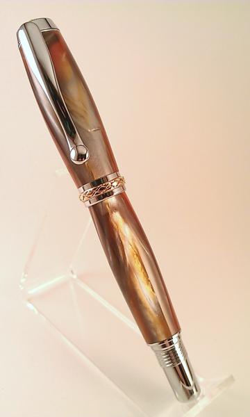

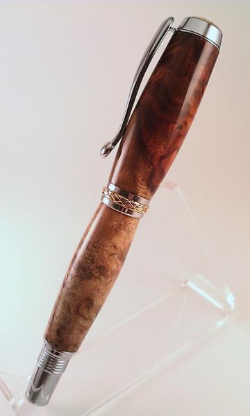

I just made two Tritons this weekend. Used 12.5mm and 10.5mm. All was good with mine. Is the hole large on one end than the other? Are you drilling with DP or lathe? Are you using center bits to keep the bits from wobbling when you first start to drill? Hope this helps.
Dave
reiddog1
Oct 14, 2011
564
Jacksonville, FL
My two from Sunday
Here ya go.

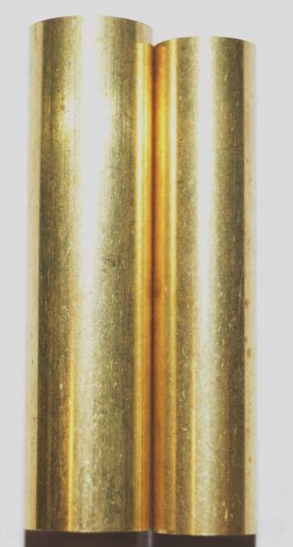

I agree with you on the tubes. Here's a picture of the tubes from a kit of mine I got from Exotics.
I've made 2 of them so far, but I don't like the proportions. From now on I'm going to make closed ended tritons, or do what Ed says and use the longer jr Gent tubes, and a longer spring.
