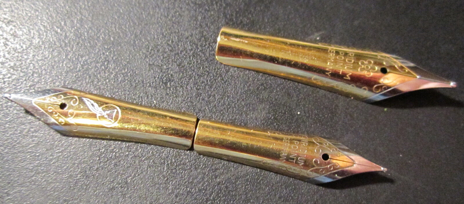

Thanks for the response. I did try it various ways and still had the same results. Here are pics of the 2 nibs, the Heritance on the left, and the stock on the right. I do notice a slight size/width variation so maybe EB sent me the wrong one? Or I just don't know what I'm doing which is entirely possible as well. :)
Charlie, dug out a Triton and scrounged up a Heritance #5 nib. Like yours there is a very slight size/curve. It fits just fine the upper right is a #6.

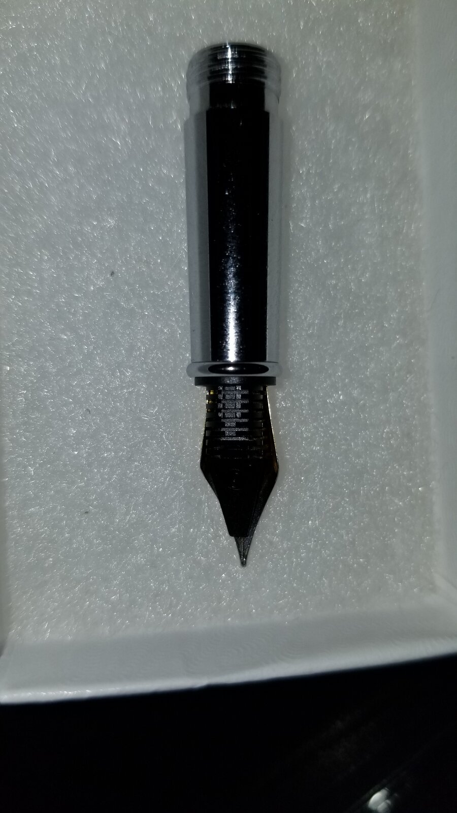

Can you take a picture of how it looks inserted.. need to see how far it's in in relation to the feed. Might just need a bit more muscle.
Here is it inserted:
On a side note, I pulled out both pieces and measured them. I mic'd the Stock non-point end width at 5.52mm and I mic'd the Heritance non-point end width at 5.12mm.

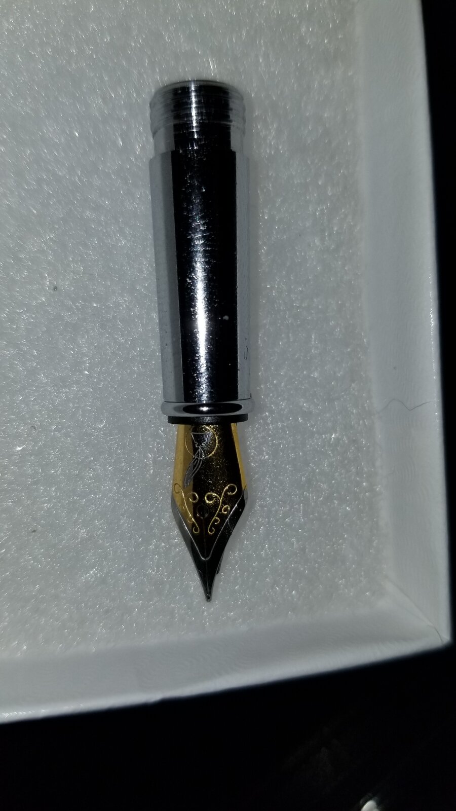

When put on the feed and fully inserted, both have about 8 ribs of the feed showing yet I can still just pull out/push in the Heritance nib with no resistance and it falls out when stood upright.
Stock:
Heritance #5:

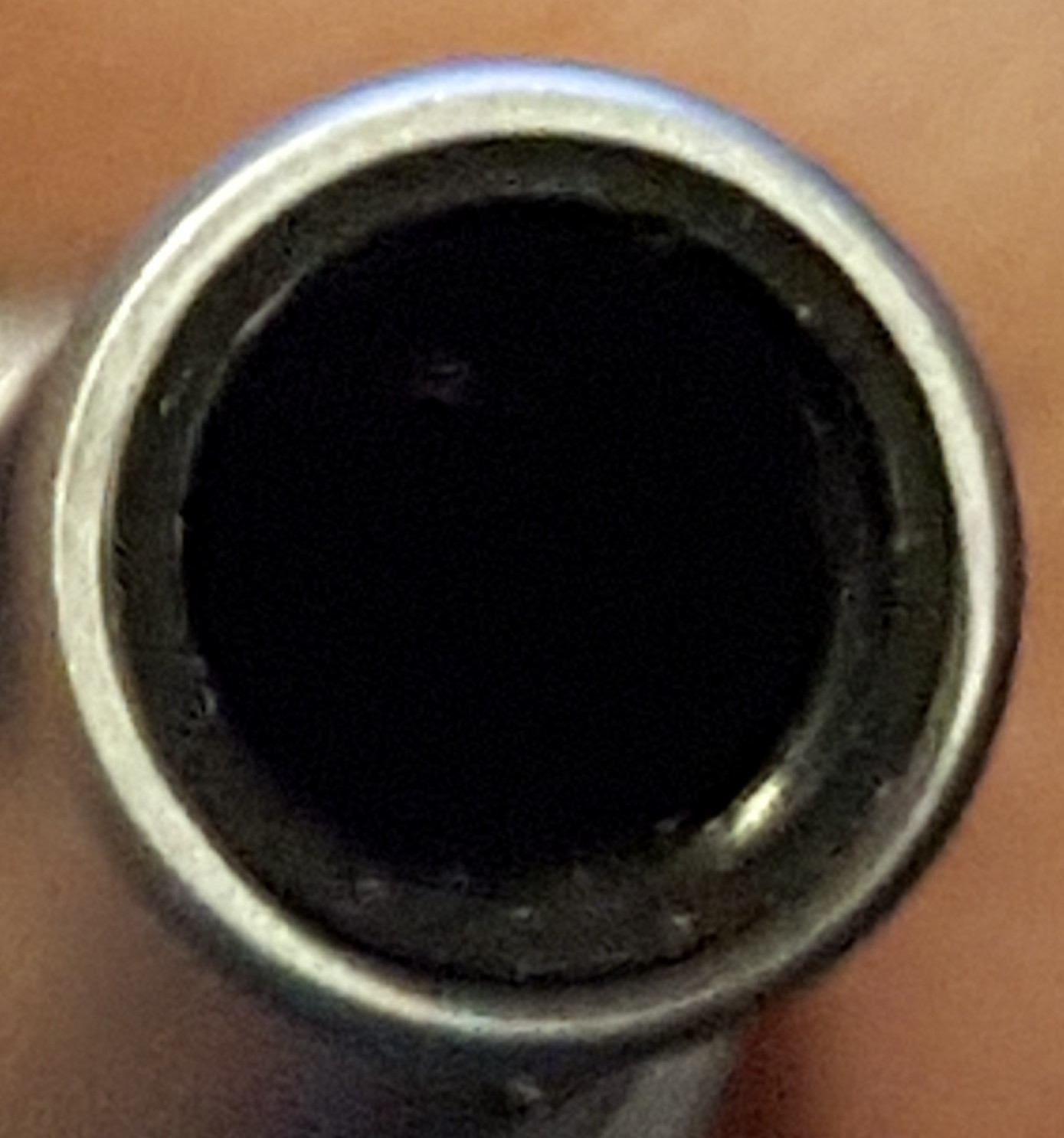

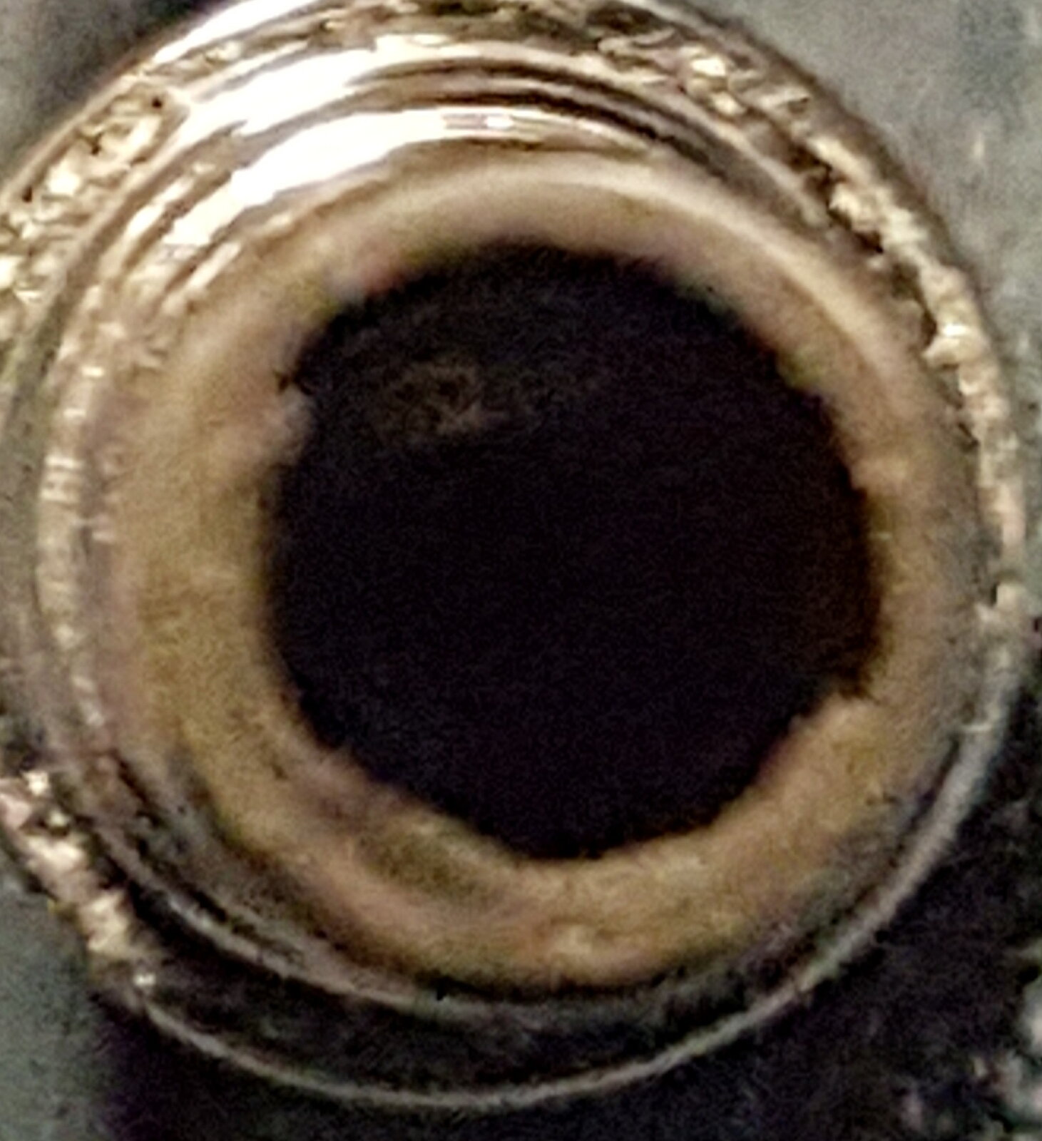

Do you have another section you can try it in. I've tried 3 Heritance nibs and they work fine. BUT I tried them in an Atrax, pen I have, and all 3 do what you describe. Swapped the feeds and still slip right out. Tried a Jr Gent and really tight. Think it's more a fitment issue with the feed housing.
Pull out the feed and look at the opening. The left one is the Atrax, note the half circle that's larger. Too much room. The one form the Triton on the right is just round. They all are technically a #5 but there is no actual international standard. If you have other kits check them out. If you find one that's round you can most likely unscrew it and swap.
Based on the measurements you posted, you might need a #5.5 nib.
