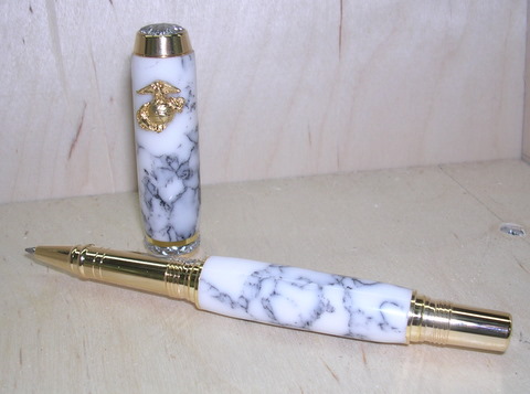

picture of tonite's Triton
This is for a customer who's husband is a retired Marine Colonel.

Nice work, Lee! ..... Hey, wait a minute.... I think that's the blank that went missing from the shop:).... Well maybe not... At least the Devildog ensignia didn't come from a proper AF household:) Hey, I recognize that hardware, too....Damned!

You're 100% keerect, Andy. The Truestone came from your shop. That particular Triton came from the local Woodcraft. The one I filched from your shop is waiting for the M3. Which will also have a Marine Eagle Globe and Anchor but I have to get it to a jeweler to bend (mold, make fit) the larger EGA to the M3.

Just bustin yo chops, Lee! The pen looks FANTASTIC!

Insignia
John, the Eagle Globe and Anchor is a lapel pin that I got from 4armedforces.com. I pinched off some of the tack, drilled the smallest hole I could in the top and epoxied the pin to the top.
The Truestone I pilfered from PenMan1's shop.
I also got some larger emblems, (1x3/4) both brass and OD from Sgt. Grit.
I have not found a good way to bend them to the right circumference for a large pen like the Triton or Jr. Gent. I plan on taking one to the local jeweler tomorrow to see what he can do. (Don't even think of putting it on a smaller pen.)

Lee, that is one beautiful and respectful pen. I am sure that he will be very happy with it. Congratulations.
