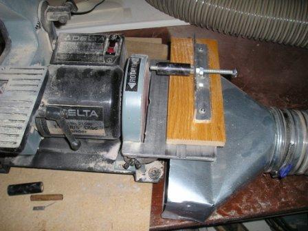

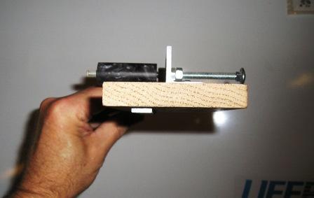

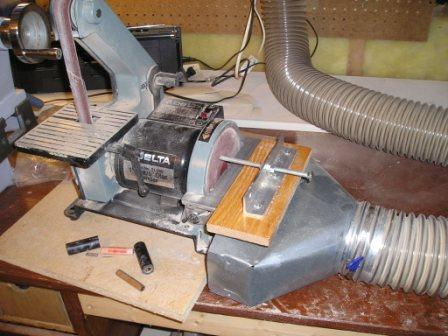

I now trim the blank on the band saw followed up by doing the final squaring and 1/8" sanding using a jig I made for my bench belt/disc sander. This completely avoids any chips or tear-outs.
Wade
I have seen other's setup for doing this but wouldn't mind seeing what you came up with too .... How about a pic or two? :)
Lenny…
It is a pretty simple jig to make. I used a 5/8" piece of red oak as the base. A piece of 1 ½" piece of 90 degree aluminum channel is mounted on the base parallel to the sanding disk. A ¼" hole is drilled through the channel and a ¼" threaded bolt is mounted to the channel at 90 degrees to the sanding disk. Finally, a 3/8" thick piece of ¼" aluminum is used on the underside of the base to track in the miter slot. The key thing is making sure all the angles are correct when you are putting everything together.
The ÂĽ" bolt accommodates the standard 7mm tube. Make up a series of trimmer sleeves using 7mm brass tubes and scraps of wood to fit the various tubes sizes for the kits you make. Slide the appropriate sized sleeve over the ÂĽ' bolt and then slide your blank over the sleeve. Turn the sanding disk on and then gently sand (trim) the ends of the blank square.
I hope this helps.

Zig613, I'm assuming you just push the blank along the bolt with your finger until it contacts the sanding disk? I mean-you don't move the jig itself?
Mike...
Yup... just slide the blanks towards the sanding disk. The jig itself remains stationary.
Wade
