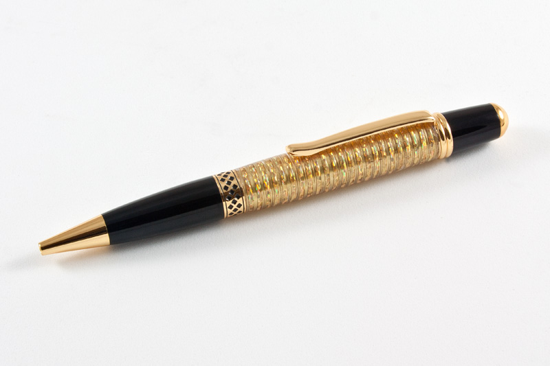

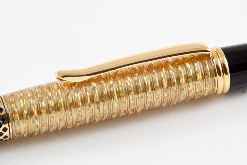

Saw this material in the craft store and thought it might look cool wrapped around a pen. What do you think?

appears to be some sort of camo as I can't see it....:biggrin:
there it is... Wow that is neat. Is it a rope that you twisted around it?

It is a gold "lacing" vinyl. Used in kids crafts. I liked the colors in it. I cast it in clear, but when turning the clear PR got so thin that it started chipping off. The thickness at the bushing ends of the tube and lacing is almost at the max. I ended up using CA to do the ends. Next time, I will probably just forego the casting and use CA for the entire blank.
