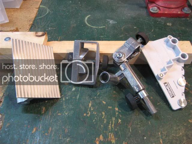

Here are the Tormek 2006 jigs that I use for lathe tool sharpening ... already had them from my Tormek 2006 purchase for flat work tool sharpening. So my additional investment for lathe tool sharpening was only for the tool rest support brackets and custom building of my own portable bench stand/mount blocks.
