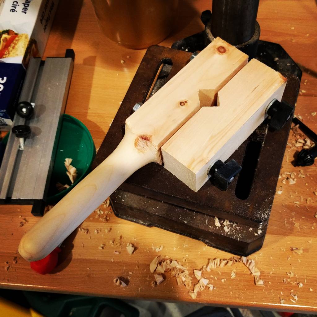

I recently made this jig from some scrap 2x2. It probably would've been better with a hinge on one end, but I didn't have one on hand.

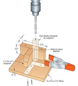

I made a simple jig something like this to drill pen blanks on my drill press when I first got started. I've since acquired a nice pen blank vise, but I still use the jig to drill stopper blanks and other things that don't fit in the pen blank vise.

I built the same jig as Edgar has shown above, but since then I've purchased and use PSI's Dedicated Pen Drilling Chuck. I'm well pleased with it.

You can't beat the simple clamps by Geoff and Edgar shown above for economy and effectiveness.
Some people, including me back when I started, think you have to spend $60+ for a drilling vise but you don't.
