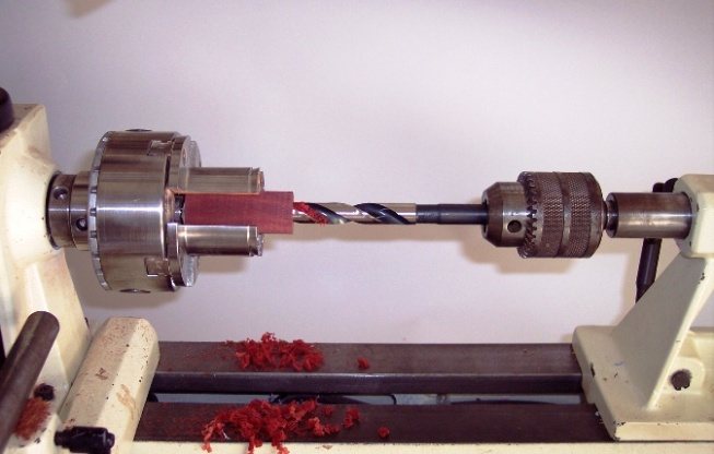

I'm also looking for ways to drill blanks out without a drill press. Can the lathe be used for this? Seems like it would be a matter of cinching it to the tailstock somehow and using hand force to press it gently into the drill bit on the headstock.

If you have a chuck with small enough jaws, the lathe can be used for drilling. Put the blank into the jaws, and bring the tailstock up with a drill chuck in it. As for sharpening, you may want to look into not using a gouge, and sticking with a skew. As you mentioned, a skew will be easy enough to sharpen by hand. A gouge can be done, but it takes practice. With a slip stone and a diamond hone, you should be able to maintain an edge, though.

A lathe can be used to drill out pen blanks and some do this regularly. I will bet that you will find this more precise than with a drill press. Also, you can use the chuck on either end. Put a small 3 or 4 inch sanding pad in the chuck and use that to sharpen your tools for the main sharpening; then use microfine sandpaper for touch ups.

Anyhow, I much appreciate the information. Anyone know of a link showing how to drill out a blank with the lathe only? Pics help me out a lot, lol.

This has been posted before but thought you might like to see it. This is how I drill 95% of my blanks:
