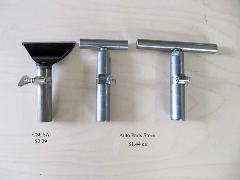

I threw in one of the CSUSA tool rest post stops on a recent order an found that it is a real time saver for me. Most of my turning is done with a Pen Pro so I have set the stop at the correct height for it, it is then a simple matter to raise the rest for other tools if needed and drop it back down on the stop to go back to the pen pro.
The $2.29 CSUSA stop has a nice big thumb screw which is convenient if you are going to make adjustments to the stop. At $1.44 from my local auto parts store a #12 hose clamp accomplishes the same thing but without the thumb screw.

Tin snips to cut off the extra length. In fact I rarely buy small clamps anymore. I buy big ones and trim to size... Except for the "special" fuel injection clamps that is.

Those 2.5" clamps look like they can only trim down about an inch... the slots are only on the leading edge of the band.
I bought a couple of the stop clamps from CUSA and have been very happy with them when using carbide tools. It allows easy and quick repositioning of the toolrest while maintaining consistant toolrest height.
