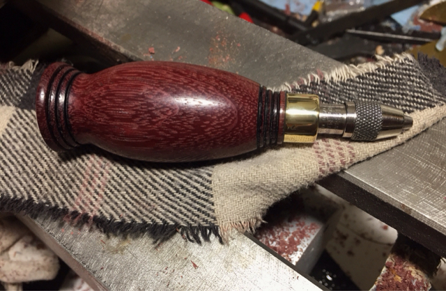

Find the piece of brown hardwood from the scrap bin. Rough it out and find out it's Purple Heart. It will be brown again shortly.

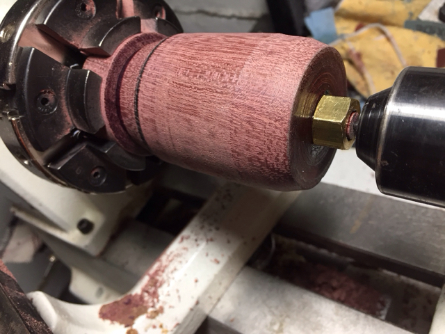

Cut the tenon, add the compression fitting and turn away.

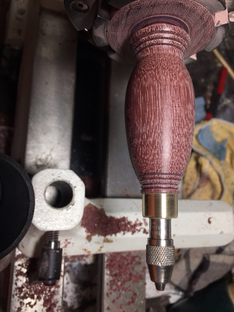

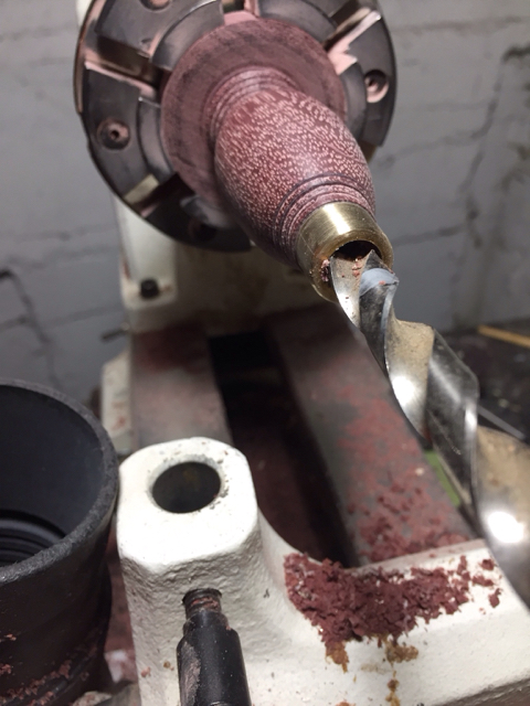

Drill it for the handle and then the collar on the pin vise.
Test fit before clean up and finish work is done.
It's now a useful tool for many projects. I use them as awl handles for hand stitching leather.
Purple Heart scrap
3/8" brass compression fitting
Size C Starrett pin vise
Five minute epoxy
Boiled linseed oil finish

On the compression fittings cut your tenon so you thread the tenon with the fitting. I use a wrench to turn the fitting on, its that tight. I turn a second small tenon that comes a smidgin out of the hole on the fitting for my center. After it's all fit I unscrew it, add epoxy and wrench it back on square to the shoulder. Let the epoxy set up and then turn it between centers. I turn the brass with my regular Sorby HSS tools. On light woods finish out the brass fitting first so you turn off any brass goobers and have clean crisp wood. Dark woods don't matter as much.
