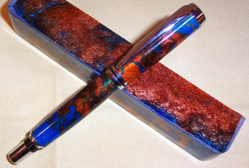

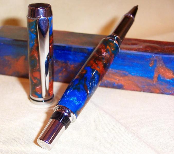

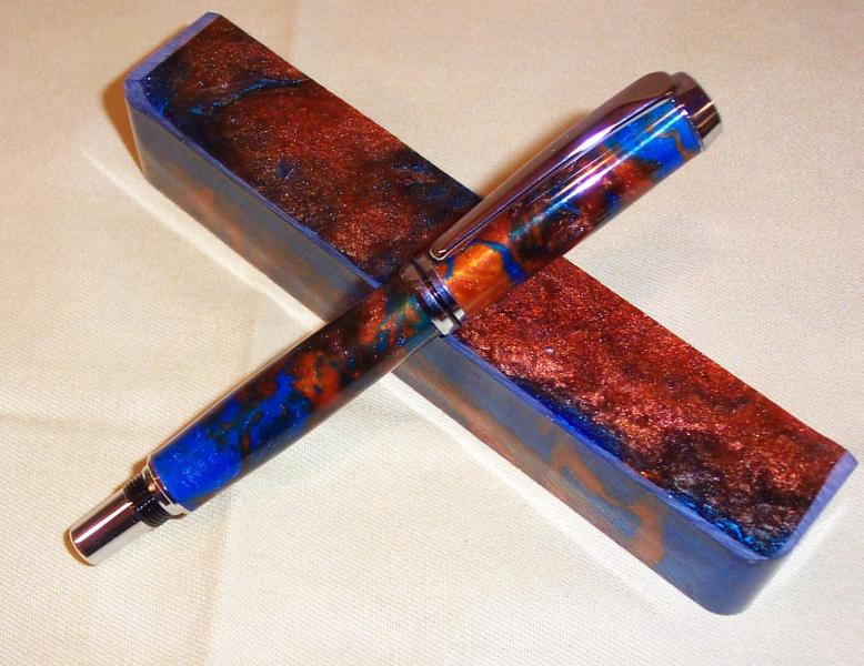

Ok, you probably don't want to hear all this but just give me a little umbrella of grace. Received a few of the Ancient Mars blanks from Exotic Blanks. Being new at this gig I just had to turn one. Holy moly was this forever a challenge. Started with the usual proceedure(won't bore with that) waited for the epox to set, knocked the corners off my blank for easier turning(learned that on this site) and placed on the mandrel for some fun. Started with good sharp tools(another insight from said site)and commence to cutting, trying to remember slow and patient, slooow and paaatient, you get the drift, finally time for sanding. Starting with the big grit to smallest and then micro to 12000 and then I got this bright idea to throw a little CA and sand some more, big, BIG mistake. So, I sanded some more up to 12000. Then noticed a lot of scratches after all this. So, I tell my self you just didn't put enough CA on. you guest it, I put more CA on and sanded again all tttthhheee wwaaayy tooo 12000000! Still not looking good, so back to Mars bar and started over again, FINALLY after 4.5 hours I have a $12,000 pen for sale!?! Any takers? Best pictures I could take, not sure what the little whiteflakes are in the picture but this blank is gorgeous, great work to EB.

Beautiful pen. I know these blanks well... You WILL get better at them.
Since you told so much, I guess I'd have couple of questions/hints... 1) You say sharp tools - skew? If not that may make a difference... The skew takes some handling, but will be worth it. 2) There is variations in sharp (I get better all the time at that too!) 3) Sanding... What grit starting with and wet or dry? Wet beats dry on these acrylics HANDS down.
Hopefully with some more experience, this won't take as long... But for being new at this, you did GREAT.

Looks nice. I have made many PR blanks that look just like that. Only thing I may suggest from exp and from your pic is the need to paint the tubes first. The blanks get so thin that most will show the tube. The white specs look to be tiny voids that are filled with dust or polish. Could be wrong but that has been my exp as well. To fix that I blow them off with compressed air after sanding.

Thanks, I did use a sharp skew. This was the only tool that seemed to prevent chipping. As far as sanding, started at 150 thru 600 and then MM but did not wet sand, sounds like part of my problem, huh? The white specks are in the pic only not on the pen. I've done a few PR blanks but this one seemed to be much thicker and quite hard. Thanks again for your advice.:wink:

mama said there'd be days like this. try some plastic polish too. but for sure, wet sanding is the only way to do this right.
Well, Well look what the cat drug in! Wet sanding would have probably saved a few hours but what the hey know better next time. Plastic polish was applied, the pics don't do it justice:mad:
