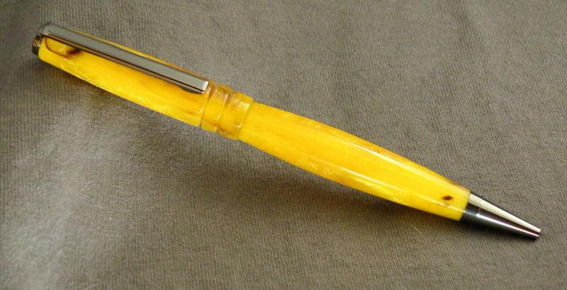

You don't need the EEE. I have some and haven't used it in months. I wet sand through 2000, then buff with Tripoli, White Diamond, then Carnuba.
This one needs to go back into the finishing for some CA build up, but I did the above with it.

Before I lost my shop space, I was using the HF buffs and the final Menard's/Weller buff. Since I'd not yet set up a buffing station, I mounted them on arbors and used the drill press. The previously posted pen was done with this method, and while I need to do some more build up, it shines great as is.

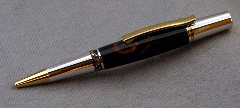

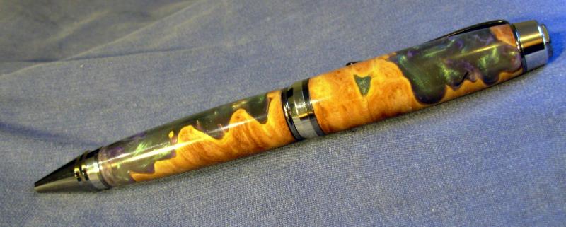

Sometime I don't even do that. Instead, I'll wet sand to 2K, and then go straight to plastic polish. The following two pens were done with this method.
