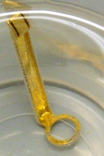

Today I took a TiGold clip from a Berea Slimline and a cap from a Rhodium Retro to work. I put the parts in about 32% Hydrochloric Acid.
First the clip went in and it started to show tiny gas bubbles after ca. 30 seconds. I took the clip out of the acid after 1 minute and rinsed it with water. The golden clip had some weird look to it, like small dark spots: the coating could be wiped off easily with a wet finger, and under it the steel clip was nicely shiny, like polished steel would look like.
Here is the clip in the acid, one sees the tiny gas bubbles:

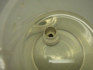

Then the retro cap went in. The cap also started to bubble within approx 15 sec and I took it out after one minute. The whole cap had small bubbles all over. The plating, however, could not be wiped off.

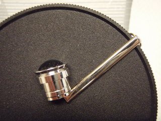

Here is the clip and the cap after rinsing in water and drying with compressed air:
One may note the shiny steel of the clip, looks nearly like the Rhodium cap. My theory behind all this is that these (very thin) platings have microscopic pores and the acid attack the underlying metal through these pores. This eventually loosens the plating and it can be wiped off. The TiGold coating could be wiped off or it was the very thin gold plating that Berea applies over their TiGold and the TiGold was dissolved in the acid - had not enough parts or time to play around. The Rhodium stayed on, though - it may have come off after a longer immersion time. The Retro cap looked later like it looked before. I am not sure from what the cap is made, it is not steel (not magnetic), I would say brass or so (got to make a scratch to find out). The clip was definitely made from steel.
These minute pores in the plating would explain what happened to some of our friends here with the Rhodium plating from CSUSA. Aggressive sweat, i.e. acidic, may have over time have the same effect as the short exposure to concentrated Hydrochloric Acid.
