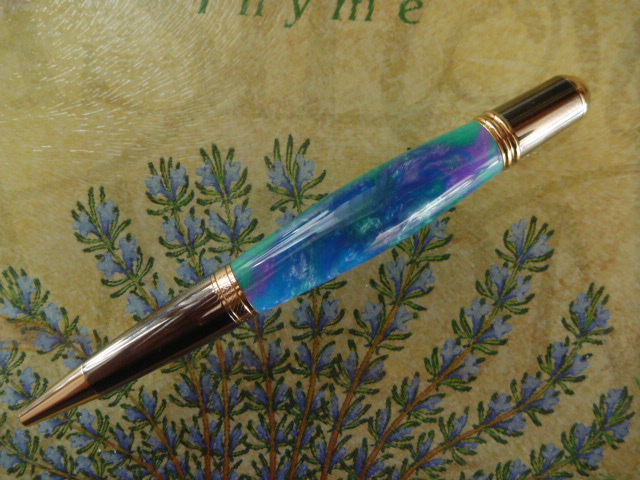

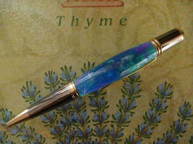

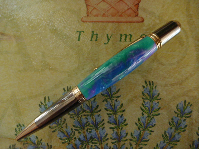

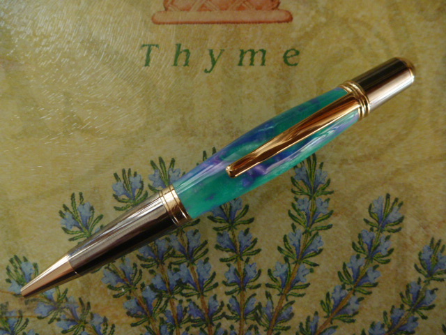

Now have at it boyz and girlz! Here are some PIX of the last one I turned with a Rockler Peacock Inlace blank. It look just fabulous in person. I gave the other half to a friend for her birthday and I might as well have given her a bar of gold for the happiness it brought her.
