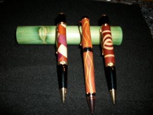

http://www.penturners.org/photos/index.php?n=10408 Here are three pens and the results of my tinting on the scrap piece of pine.
Some work to do to get better, but now I have a basic idea of how to do it.
