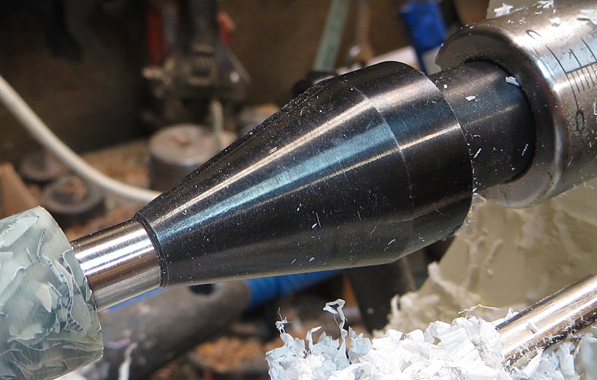

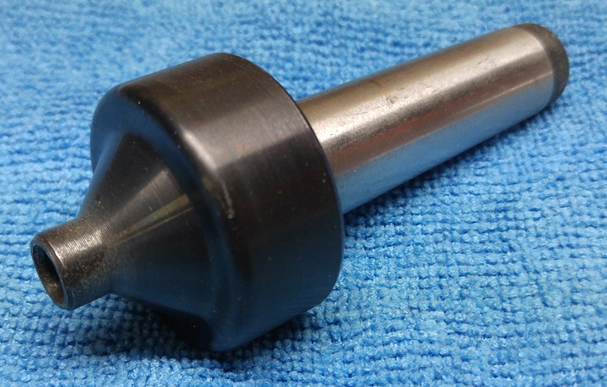

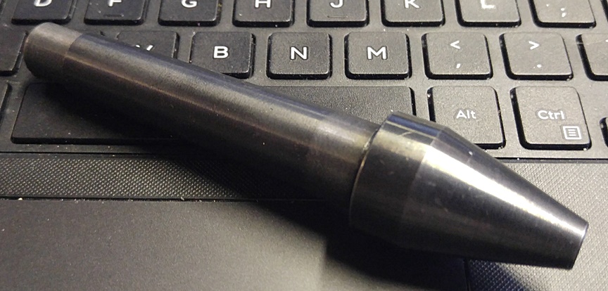

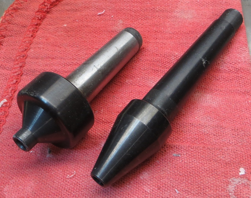

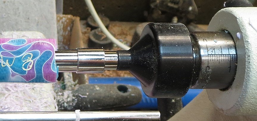

I've tried the mandrel savers from both PSI and CSUSA. I don't really like using either of them. Can't get the blank tight enough with them, and I don't like putting that much pressure on my headstock bearings. But I know a lot of pen turners use and love them. I will say that in my opinion the CSUSA version is higher quality than the PSI. Its longer tapered nose also allows more clearance on the right side of the blank. It's now only $30, $10 less than it used to be.
https://www.woodturnerscatalog.com/p/16/5492/Precision-Machine-Pen-Center?term=machine center
https://www.pennstateind.com/store/PKMSTS2.html
