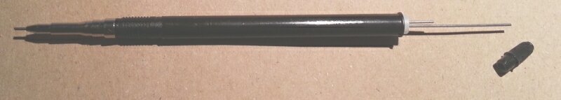

Recently I purchased some of these new lead mechanisms offered by David Lin from Timbertbits. Here: https://www.timberbits.com/lead-mechanism.html
Not to replace the Schmidt pencil mechanisms but in order to offer a pencil alternative to be adapted without any modification on some (Parker) pen kits I'm selling. David Lin advertises this mechanism to fit Cigar or Sierra pen kits. After fixing a small issue with David, seemingly due to transportation, this mechanism can indeed be adapted on these two pen kits (with their standard transmission) without any alteration and seems to work pretty fine. Also, seemingly it can fit a Schmidt transmission that we find on the "convertible" pen kits like Berea's "Perfect Fit" or "El Grande" or even the "Cigar pencil".
Doesn't work with Clicker and Elegant Beauty though.
Of course the above short report is not a quality record. One has to try more thoroughly this mechanism before suggesting any quality opinion.

Ok, now that is pretty slick. Can it hold multiple pieces of lead or just one at a time and how do you reload it? I didn't see that info on the video
chrisk
Nov 4, 2009
822
Brussels, Belgium
The mechanism comes with 3 leads. By pulling the cap off, you can reload. I filled up to 7 leads on one mechanism.
