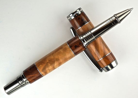

Here is another segmented pen. This time I used much thicker aluminum. I just love this combination of woods.

LOVE this pen!!! I've been caught up turning segmented pens very similar to this one for the past few weeks and it just "works". Very nice job, and the woods work great together. Moving up from the "pop can" aluminum to something thicker really helps. Two thumbs up!!!:good::good:
Oh and how did you do your finish? more of a satin finish than the gloss looks really nice on this one.

I use DoctorsWoodShop finishes. It has taken me a bit of time to get a good method to get a really good finish but it is worth the time taken. I really like this product and am on my second bottle of it now. Great stuff and very durable. My carry pen was finished with it almost a year ago and still looks pretty good.

metal seps?
I give up. Where does the metal come from. Tried it with foil to disastrous results.
love the look. how badly does it eat tools?

I am sure Mike will jump in and explain but in the mean time I would like to say foil is way too thin and do not waste your time with it. You will not see the results very well. Home Depot or lowes sells aluminum flashing in rolls. Buy yourself the smallest roll you can and use that. They also carry thicker stuff in one of the other isles but you will find the roll stuff where the gutters are.
Remember to sand or scuff all sides when gluing. As far as tools, any wood turning tool will turn aluminum and being Mike used very thin stuff there is not much noticable difference with any tool. When you start using some of the thicker stuff you may want to opt for a carbide tool but not totally necessary. Just means more sharping time with wood tools.

I agree with all that John T. said. I use flashing and recycled soda cans. I use both carbide and a HSS skew and mostly the skew now. Keep it nice and sharp and all will cut like butter. The rougher the sandpaper the better I use 100 grit on my aluminum it gives lots of places for the epoxy to cling to.
