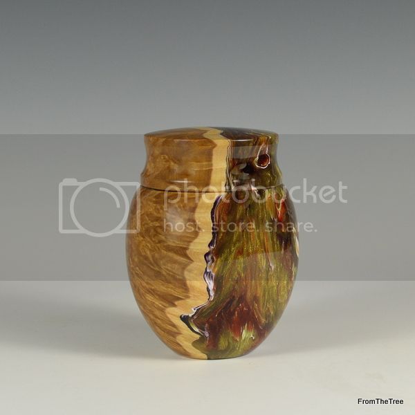

Three hybrid boxes

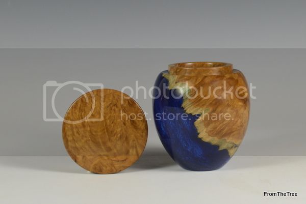

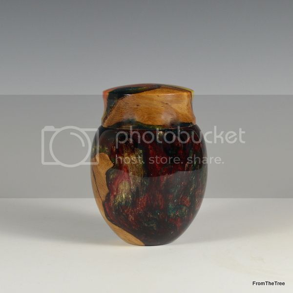

Really great! I've been turning for a couple years, but nothing other than pens and "spindle-stuff" -- tool handles, peppermills. Over Christmas I bought a bowl gouge (minus handle, of course!) so I could try some bowls and boxes.
I really want to try now that I've seen these incredible boxes! I'd be interested to know if you made the blanks, and what you used to fill the voids.
Apr 16, 2010
699
Leicestershire, U.K
thank you for all of your kind comments and "likes"
LeeR: I do make the blanks myself, a piece of burr is placed into a mold and the resin is poured in, after the resin is cured I have a solid blank which I mount on the lathe and turn just like you would any other really dense woods i.e cocobolo, lignum vitae etc the slight difference comes in the finishing of hybrid material as I prefer to use a 3 stage buffing process which is something that I wouldn't use on a traditional wooden box.
