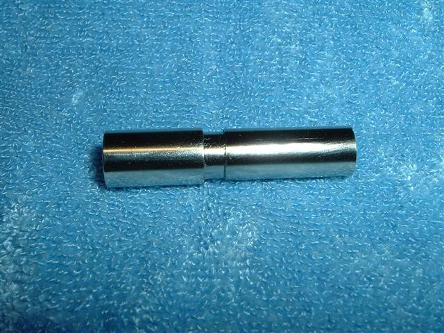

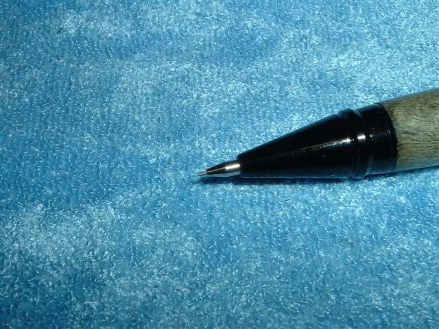

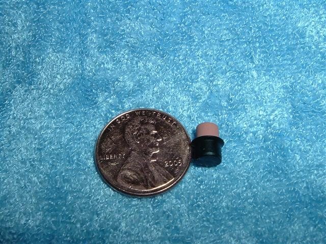

Did you know that you can take a 3/32" drill and open up that little center hole in a cigar twist mechanism:
Put a Schmidt pencil mechanism in:
And make a pencil from the kit?
If you get a little play and can't live with it you can shorten the lower tube a little or put in a spring from an old click pen or even shorten the spring of the refill you just took out.
You can pull the same trick drilling the twist mechanism of the Atlas and you won't have to cut the pencil mechanism.
This opens up a world of possibilities don't you think?
You now have the opportunity to make pen & pencil sets in the whole line of platings.

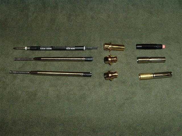

My reason for trying the Schmidt mechanism was due to the fact that I had just started making the Perfect Fit by the "b" company at the time.
I had already made a few Wood Craft pencils as in the Euro style or American Classic and the fact that the pencil kits were exhorbatantly more expensive bothered me.
Also in some cases it required different bushings.
What peaked my curiosity was the fact that the Perfect Fit could be converted to a pencil by just removing the Parker style ink refill and inserting the Schmidt mechanizm.($2.00)
This was far less expensive than a Euro Pencil kit.
Since the ink refills are all the same in the Parker style pens I just tried the Schmidt in the Parker Pens I had out of curiosity.
It happened to work in some but not all.

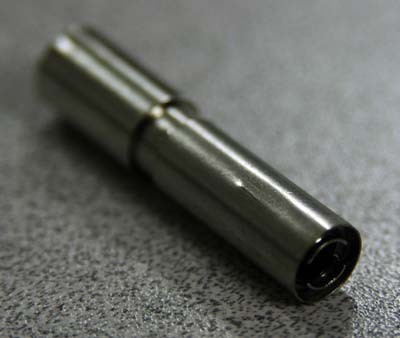

Point of interest Tom,
The Woodcraft cigar kit (at least the ones I have) has a different twist mechanism than the ones from Woodturningz and Arizona Silhouette (maybe others to but these are all I have purchased so far) The woodcraft twist mechanism is all metal and fairly easy to disassemble. I use these twist mechanisms. Disassemble them completely, polish everything inside so it's nice and smooth, spray the internals with dry moly, use a drop of instrument oil and it snaps back to center.
Scubaman;
I misunderstood the intent your post(s) and took them to be an attack, which happens so often here. In doing a little research I have found that you are not that type of person and I apologize to you for my misunderstanding.
Yes, the two springs will have opposition of forces but I have found that it is not enough of an opposition to unlock the mechanism as it needt to be pushed down nearly an 3/32 of an inch before it unlocks.

Unfortunately Tom,
If you don't have the Woodcraft twist mechanism (which is completely made of metal) my technique will not work. I will post pictures tonight if I get time but the Woodcraft mechanism is different than the others. At least the ones I have are different.

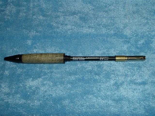

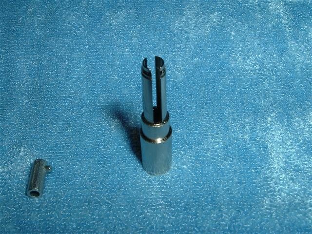

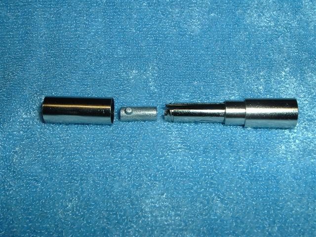

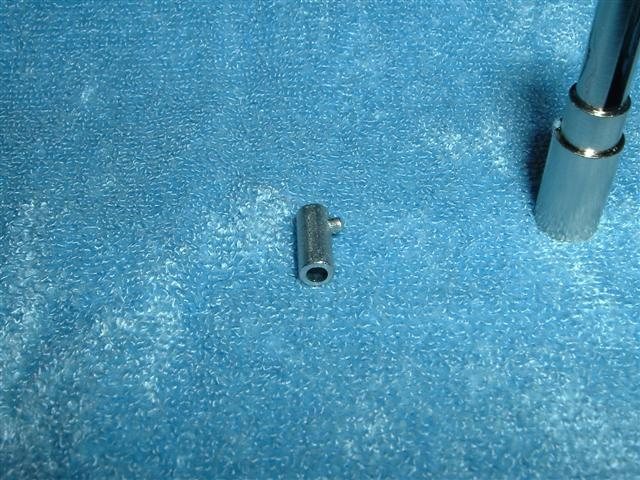

Here you go Griz;
Woodcraft mechanism:

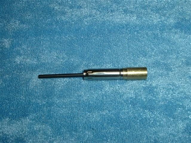

Disassembled: Just need a pair of needle nosed pliers to squeeze the "claw" on the top VERY GENTLY.
Polish this piece:
And the section in which it rides:
I then spray it small "pusher" with Dry moly and use a toothpick to get it on the channel that the "pusher" rides in. A drop or two of instrument oil before reassembly and you have a mechanism, which "snaps" to center all by its lonesome.
But alas, as others have said "If it does not have an eraser it's just a lead holder"........ I just wanted to show you the pitiful excuse for an eraser that is provided with the "real" cigar pencil. Here it is next to a plain old penny.
I do hope there is another adventuress sole out there who has a woodcraft cigar kit who can verify that indeed you can make it into a "snap mechanism" I want to know if my method can be verified by a third party of it I just happen to be extremely lucky?

Tranny in very first picture…..I assume this is the one that was reamed out. What company did it come from??

The tranny in the first picture came from Woodturningz (I don’t know whose kit it is)
It is possible to break off the top but if you sell the pen and the customer needs to replace the mechanism will they know to do that? Also, there is a possibility that the mechanism can be placed in the pen at a very slight angle, over time this could cause the “spike†to bend and become useless. I think that leaving this “spike†intact helps keep things in better alignment. My intent is to nor alter the pencil mechanism if I don’t have to but if you want to make a pencil and the mechanism does not have a hole in it I don’t see where you would have much choice.
I cannot answer your single twist question because every cigar kit I have made to date has a double twist mechanism.
The second set of pictures is the twist mechanism from a Woodcraft kit. I don’t know who makes them but I bought 100 kits a little more than a year ago and so far all of the twist mechanism’s have been all metal
Yes, I was talking about polishing the woodcraft mechanism and that one did not need to be drilled out to accept the pencil mechanism
You might be able to get away with soaking the all metal twist mechanism in acetone to dissolve the yak fat that is in then and lubricate it with really good oil but I have not had first hand experience with it so I am just speculating.
Hope this helps and if you have more questions, I’ll do my best to answer them.

".....I just wanted to show you the pitiful excuse for an eraser that is provided with the "real" cigar pencil....."
Amazing!!!

Here’s a picture that might answer more questions.
On top of the picture is a mechanism and assembly from a woodcraft cigar pencil I purchased 2 weeks ago. Notice the pencil mechanism is a Schmidt and the twist mechanism is also the same as on a perfect fit. In fact I tested a twist mechanism from a perfect fir and it works.
The middle of the picture shows a mechanism and assembly from a woodcraft cigar pen. Note the twist mechanism is all metal and is easy to disassemble and polish to get the snappy "return to neutral" that the "real" pencil kit does. It does not need to be drilled out (at lease the 30 I have left) for the pencil conversion.
The lower piece in the picture is a mechanism and assembly from a woodturningz cigar pen. note brass and chrome with a green plastic "pusher " inside. This one does need to be drilled out for the pencil conversion.
If your cigar mechanism is a single twist, then all the better. You need just to turn it one way until it stops to advance the lead and turn it the other way until it stops to lock it.
As a side note: I'm going to experiment with some of the PSI kits to see If I can get a single twist mechanism to work for the pencil conversion. Only problem is that we're now getting to where it would make the conversion economically impractical.
Hope this helps.

Wow, I'm lost. There's so much info here. I got the e-mail from Randy requesting a pic of our mechanisms. Eric, our customer service manager, turned some cigar pens this weekend so here's one from his newly turned cigar pen. I hope this helps. If not, let me knwo and I'll try to get the info you need.
