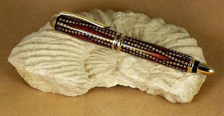

Everyone knows I didn't make this blank! It was a gift that I tried my best to do justice to. Any seen and/or imagined errors are mine, not those of the blank maker.

Very COOL pen. Could you explain it a little bit? How was it made? What materials are those? Thanks for sharing such a unique pen picture with us!

There aren't any errors.
It is very nice. The blank is beautiful.
Great choice of kits, and outstanding workmanship.
The twists in the center band and the twists down the length work well together.
Two thumbs up!!!

Thank you for all the nice compliments. Frankly, most of the credit is not mine, as I would NEVER attempt to construct such a blank. Turning and finishing it was a fun adventure.
For those who asked, the following is information on the basis of the blank:
The base blank is made of blood wood.
Each "wave" repeats six times around the blank in each direction.
Each set of waves is parallel to each other,
The white pieces are diamond brand toothpicks.
The black pieces are Sauers dyed veneers
If the toothpicks used to make the pen were laid end to end they would extend 20 feet.
There are 120+- used.
The blank was glued up with CA

Top marks, both of you. Eagle for his painstaking attention to detail in making the blank(s) and Cav for having the guts to turn it!![8D]
I would hate to call the man up and say ' Er, sorry Eagle, you know that blank that you gave me.....' [B)]

Fantastic work on that Eaglized blank. I have 8 of his blanks just waiting for me to get the time to turn them and try to do them justice. He is a true magician with wood blanks. I also love his "pentarsia" pen. Great work. [^][^]

Yes, Steven, I HAVE had that experience!!!
Blew it up while attempting to drill. I felt terrible, it was PR and I am SUPPOSED to be GOOD at PR.
Eagle's response: "I made the SOB, I can MAKE MORE!!" He could not have BEEN more understanding. So, yes, EVERY blank is a new challenge. But, those who choose not to be challenged will NEVER improve. (And I SURE don't have to tell YOU about innovation!!! Hopefully, this will lead others to ATTEMPT Eagle's blanks, however.
THEY ARE FOR SALE!!!!! E-mail me for more info. (I direct you to Eagle.)

The appearance of chatoyance in the toothpicks is quite something.
The plating quite compliments the blank and the CB really emphasizes the black and white waves. I really like this pen.
You know, never having met Eagle, the picture I have of him in my head is one of those nerdy, eccentric gadget guys in the movies who wears those funny/headset glasses/goggles contraptions with all the lenses and lupes that move in and out, making his eyeballs look ginormous.
Either that, or he's only about 14" tall, and uses both hands to hold his tweezers while he stomps out a molecule of superglue from those little metal toothpaste shaped crazy glue tubes. [:D]
Either way, I can't even imagine measuring 20 feet of toothpicks, let alone do anything so amazing with them.
