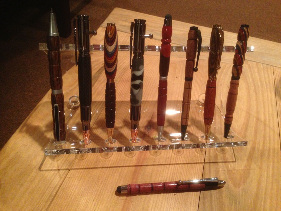

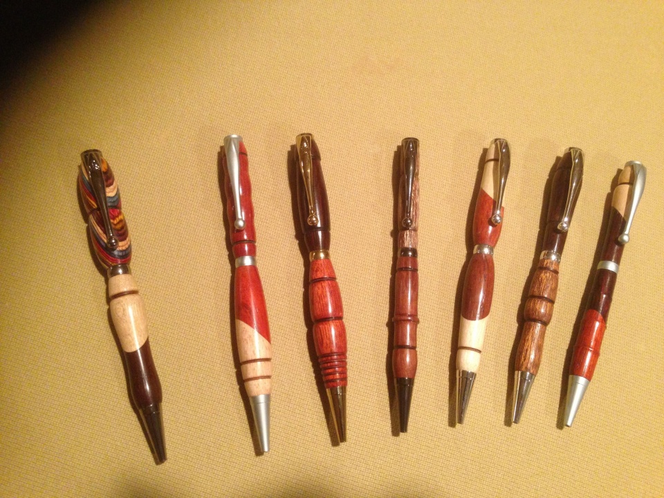

I'm new also. Do not under estimate Slimlines. You can make a very creative pen with that kit. Practice with anything cheap. I learn from making every mistake once or twice. Forgetabout the CA. It's a mess, it stinks, my towel caught fire. Here are some of my Slimlines. Have fun. Be safe...protect your face,eyes & ears. Wear your safety stuff.
