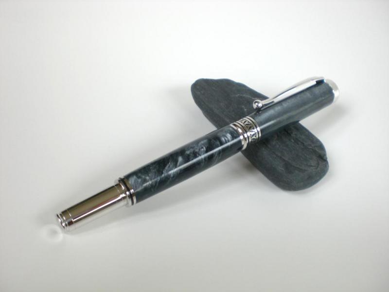

I have a customer that wants small diameter pens as well. It has been a challenge to find what one with smaller center band that will not distract from the pen. I have tried a few New Series from Berea that I bought from Beartooth Woods. They are smaller but the center band is pretty wild for her.
I have attached a mother of pearl trustone that I made last fall.

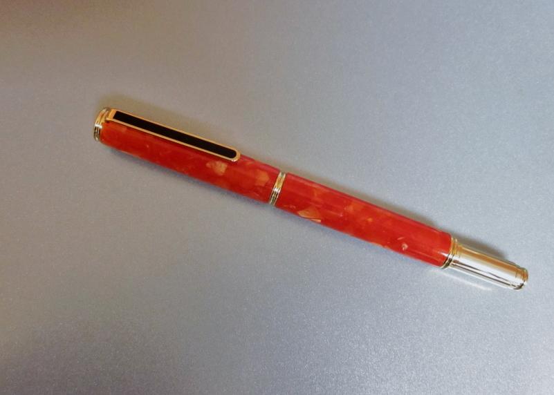

I like the Artisan from CSUSA shown below. Only problem is it's only available in gold plating. It's on 10mm tubes, about the thinnest rollerball I know of.
