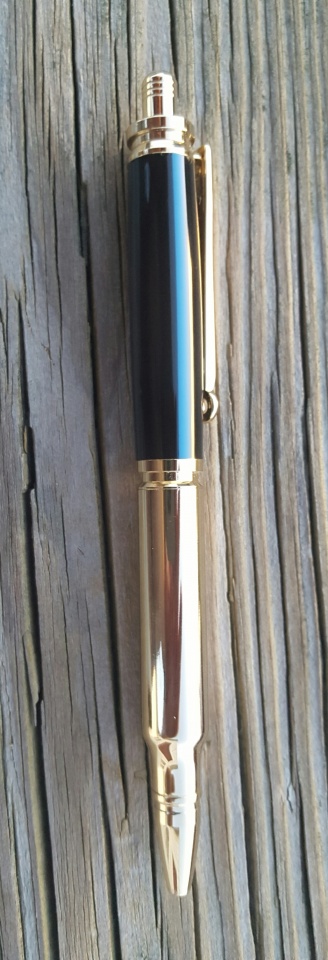

Pen Blank: Thin Blue Line AA-79
Vender: Bereahardwoods.com
Cost: $4.00
The bad: I was glad I didn't get this blank years ago. For me it was a very brittle and chippy blank. Which surprised me with it being advertised as an Acrylic Acetate blank. I turned at high speed and sharpened my tool and did lighter cuts.
With this blank being as brittle be careful putting your pen components together, because they will crack. Yes I messed up and got the nib a little off when I was inserting it, causing a crack.
The Good: Now the thing that amazed me was how easy it was to finish this blank and get a great finish. I wet sanded, used the Acrylic Finishing Pads, and buffed it on the wheel.
There is no need to back paint this blank. I also turned a slimline and had no tube showing.
Would I recommend this blank? This is where my opinion varies. If you are asking my advice or willing to take my advice on if you should get an acrylic acetate (no matter how brittle), you probably are not ready for it, because the ends may chip on you. If I had gotten this blank 4 years ago, I don't think I would have had much success in turning it.
How well will this blank on a pen sell? First of all you know your market, if you sell 2 pens every 6 months, chances are you are not in a great market. With that being said, the Thin Blue Line blank has a limited group of people that will get this pen, so it is really a toss up. I had a special order for a thin blue line pen, and ordered a couple of these. When I order from somewhere that has this blank, I may pick up a couple more just to have on hand.
Any questions please let me know.
*This is not an advertisement for any vender or blank. The above are my personal opinions, where I got the blank, and the cost. If any feel I am bashing or talking to negative, please understand what I am trying to do is offer a true opinion. My photos are not the greatest, and the preturned blank was taken from a web site.
