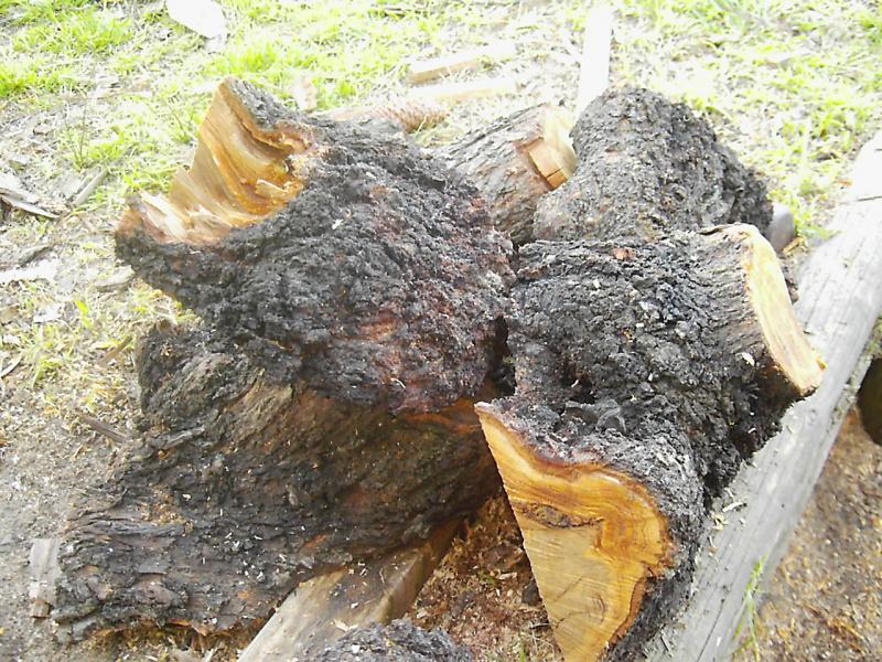

Hi everyone,

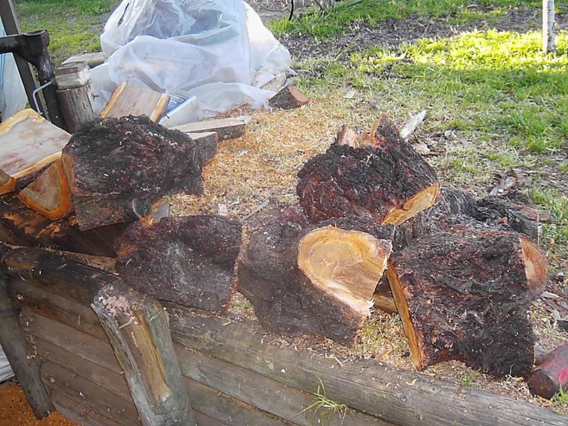

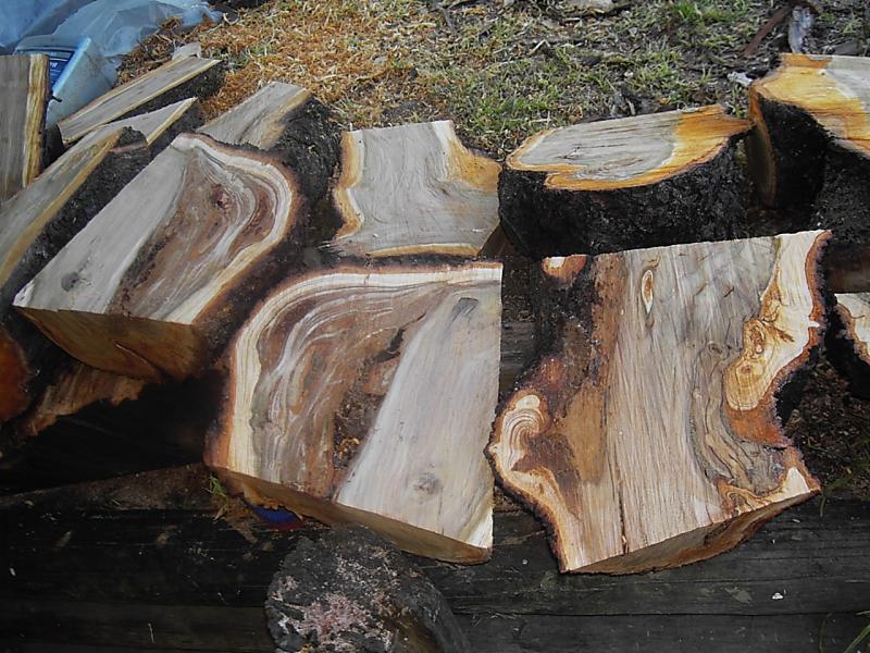

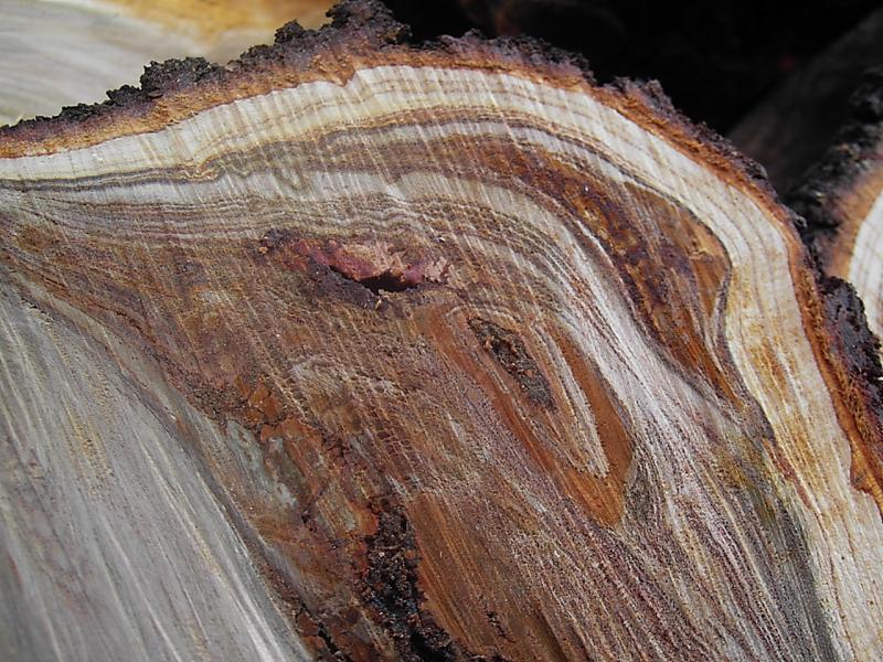

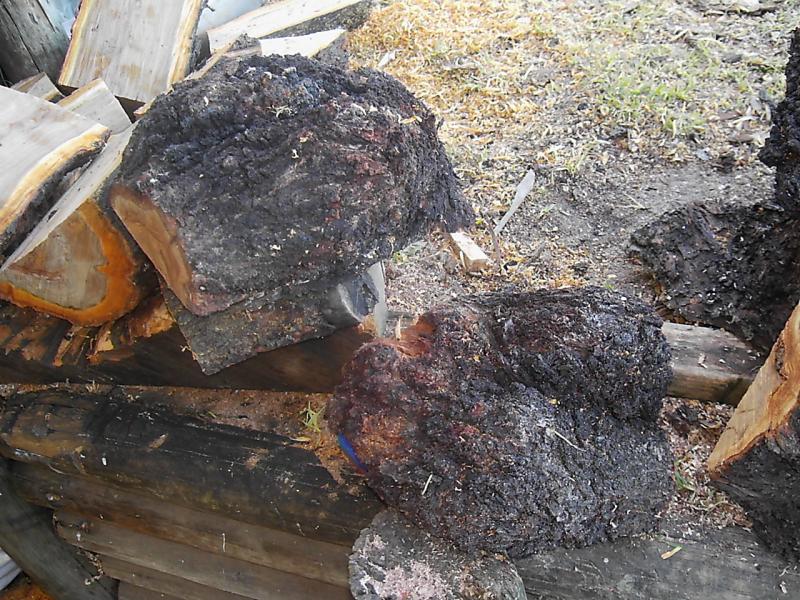

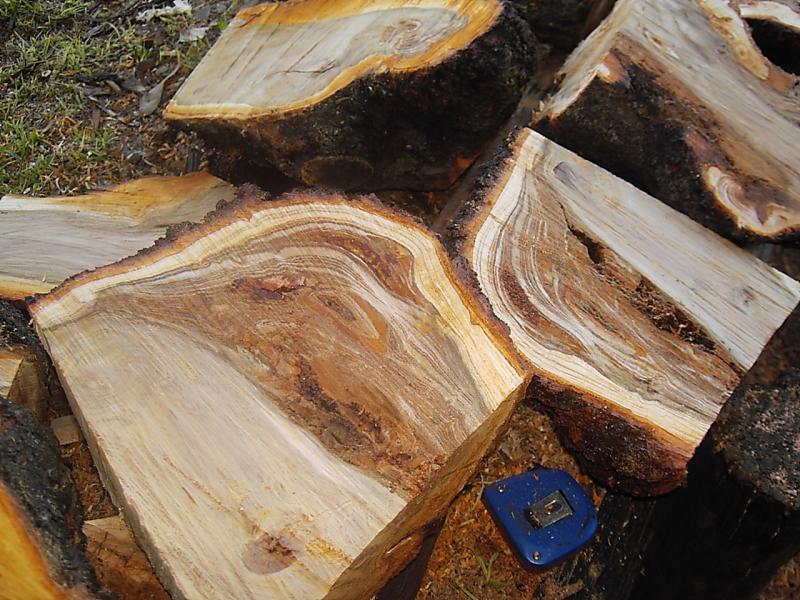

Last Wednesday (our shopping day) we went to McLaren vale (25km away) to do our normal fortnight stock-up of food and other stuff, and when we were crossing the town I spotted (my wife Merissa was driving...!) a few very old almond trees that have been given a super heavy air cut (trimming), leaving the trunk 3 feet of the ground and not much more. The branches and small rubbish has been taken away, and all the logs cut were under each tree, piled-up neatly...!

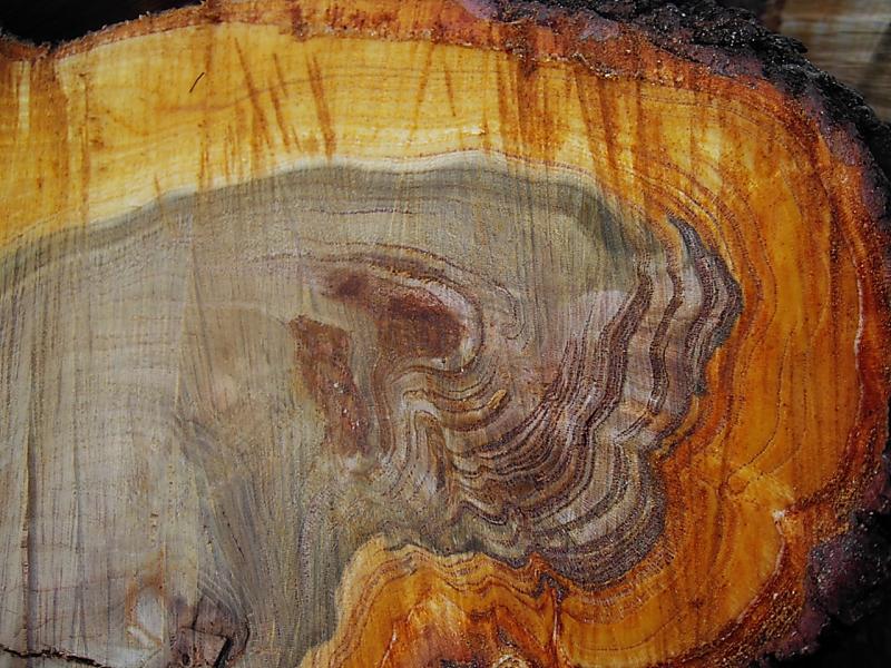

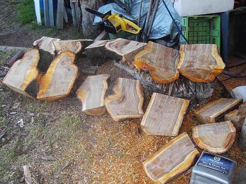

While Merissa was doing some shopping I went back to the wood location by foot and notice an old fellow parked on his drive way, reading the news paper, or at least it looked like, which I find out that we was guarding the wood to make sure it would disappear. He was actually the owner of that house and the trees next to it, about 20 or so, he lives alone but he lived there all his life and his father lived there all his life also, the father was the one that planted those almond trees in the early 1900's, so he said to Merissa...!:eek::wink:
Anyway, I approach the old fellow and asked what he was going to do with the wood and even before I had time to say any more, we got all aggressive and offensive about people wanting to take the wood for nothing. We was actually sleeping in the car with is little dog, to make sure the wood wouldn't be stolen. He keep yelling out that the wood was not for give away or for sale but was going to his son who had done all the cutting the previous weekend but didn't have the time to come and pick-it-up. Again, this was Wednesday...!:eek:
While he was going on an on about his son's wood, I spotted a few decent burls on a couple of logs they have cut, just a couple of meters beside where he had the vehicle parked so, I had to come up with a plan to score some of those burls from the old fellow..!:rolleyes: Unfortunately for trees such as almond or any fruit trees, these burled type formations are in fact a fruit tree disease and is developed by the tree producing a yellow sap type honey that kills the tree by stopping the nutrients to pass that point as if was a barrier. After a little while the tree gets a few of these on the main branches and unless they are cut back dramatically, the tree just dies...!
Most fruit or nut growers, use this opportunity to "graft" the trunk with a healthy shoot normally collected/cut from a healthy tree or through a nursery! in this case I don't know that he is going to do, maybe he will wait for some new shoots to grow from the cuts...!:confused:
So, and while waiting for the wife's finishing shopping, as I normally do other things that need to be done, I come up with a strategy that should have some chance of success, there is, the old fellow lives alone and I could see that he din't have many friends around so I've thought, why not try the nice looking female persuasion, something that they are so well famous for...!:eek::wink:
I picked up the wife and explained the situation and also my "cunning" idea to score some of that burled wood, which she didn't have any problems with, oh... I'm a lucky man...!:biggrin: She asked me, how much do you want...!:eek: geez, I tough, she is very confident to change this old fellow's mind...! so I replied, as much as you can, just remember to park the vehicle in the driveway also so that you don't have to go far if you get some...!
I also told her where to look for the burled pieces, while she worked out what to say...! She was going to be the wood bowls turner from Mt.Compass, in need of some burled almond old wood...! yeah, I said, that will work...!:wink:
I was left not far but he couldn't see me while I could see what was going on, and bugger me, it didn't take her 1 minute before the old fellow got out of the car, got a wheel-barrow and let her pick-up what she wanted while he was pushing the barrow...!:eek: bloody hell, I've though, when and at the same time I was over the moon with what I was seeing being put through the Wagons back door...!:biggrin::tongue:
No doubt that we man are strange creatures when it comes to women, why is that...??? well..., obviously that at the age of 52 and been married twice, I know the answer but still puzzles the living life out of me...!:wink:
And no Mr. Bruce (Gofer), I'm not trying to compete with you or play the game of, show me yours I will show you mine...!:eek: sort of speak, off-course...!:biggrin:

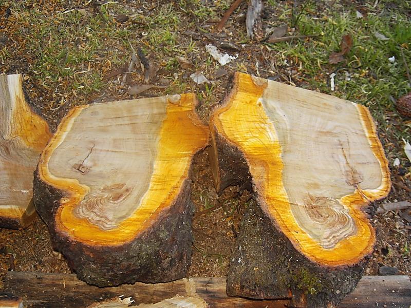

This is what we brought home last Wednesday, after I slice it open in a few pieces...!:)

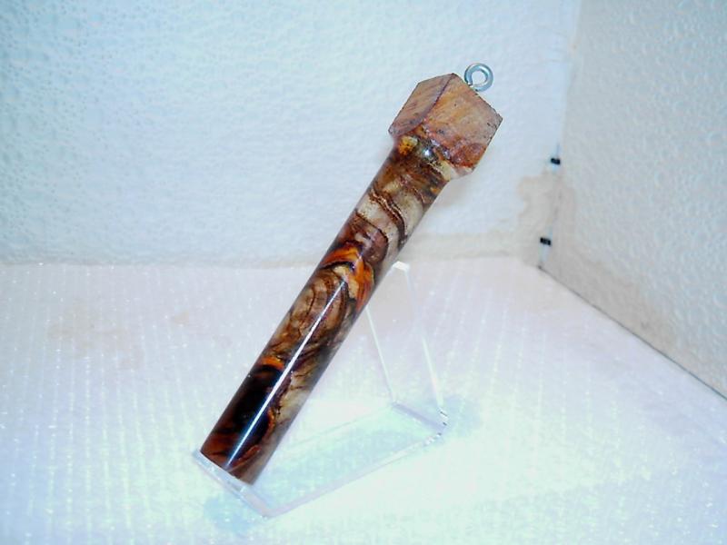

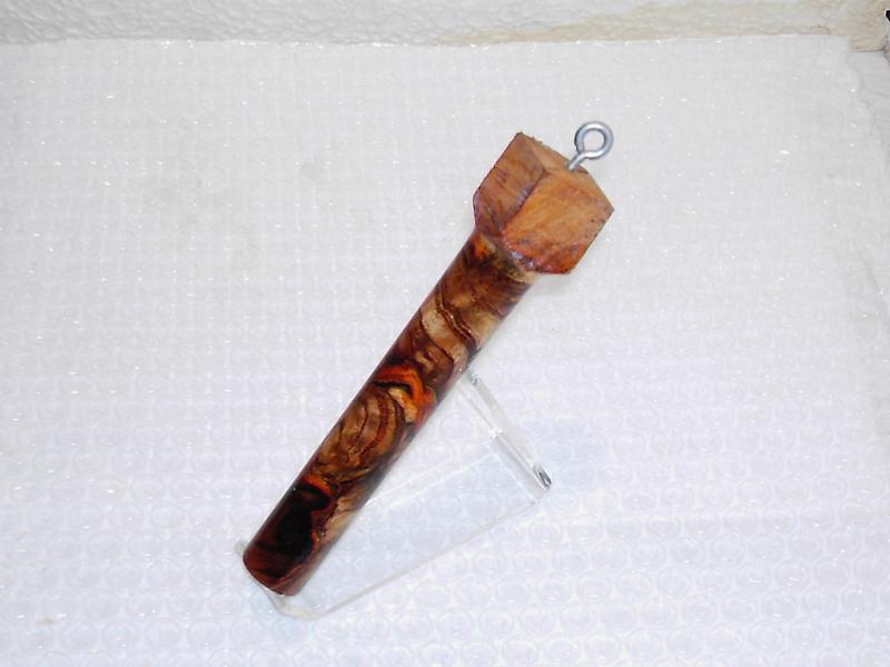

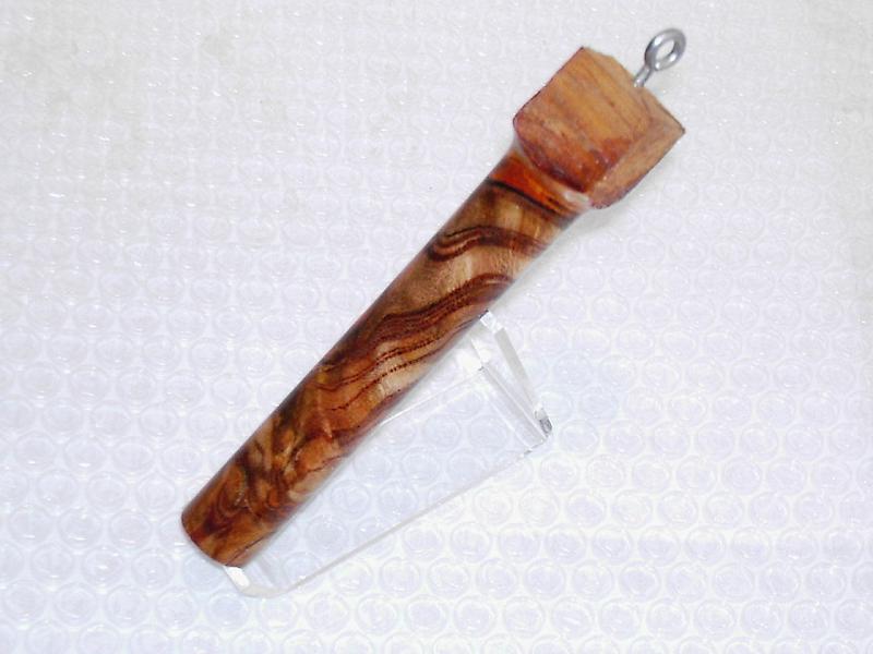

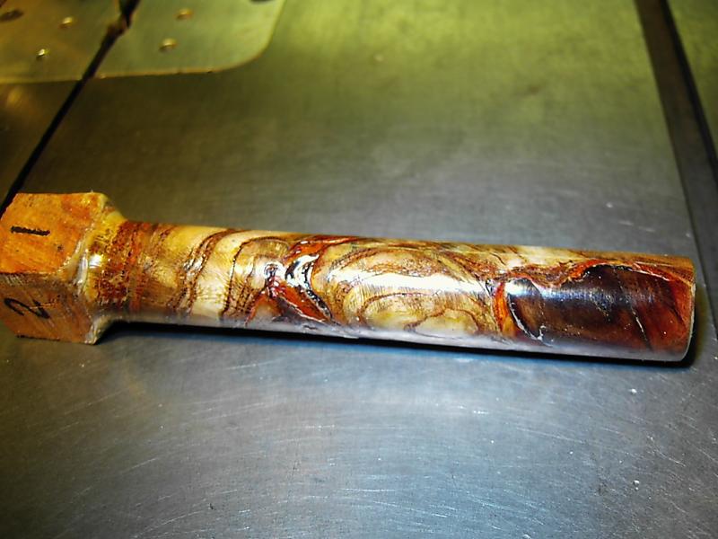

Hi everyone,

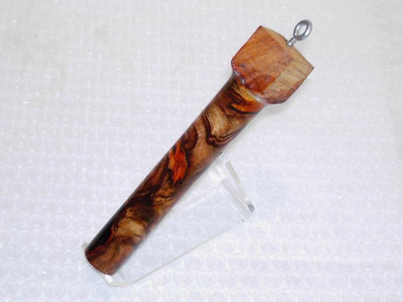

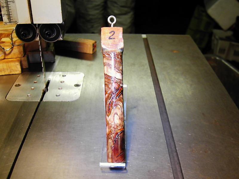

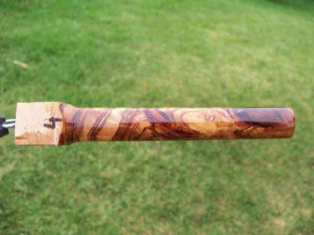

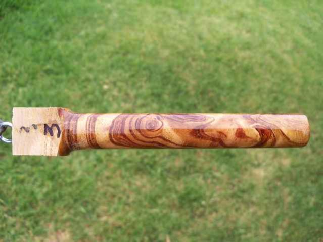

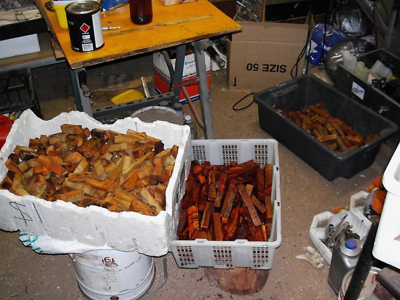

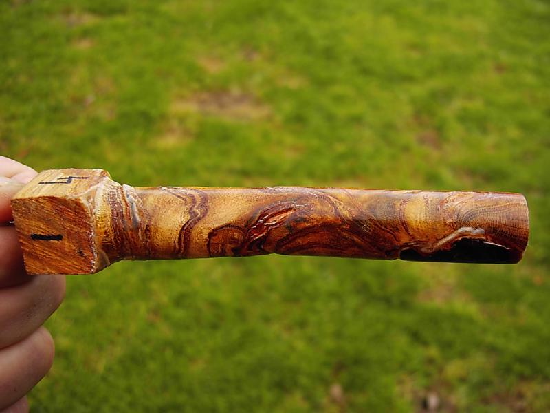

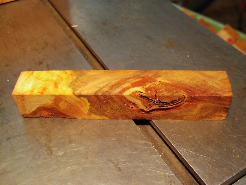

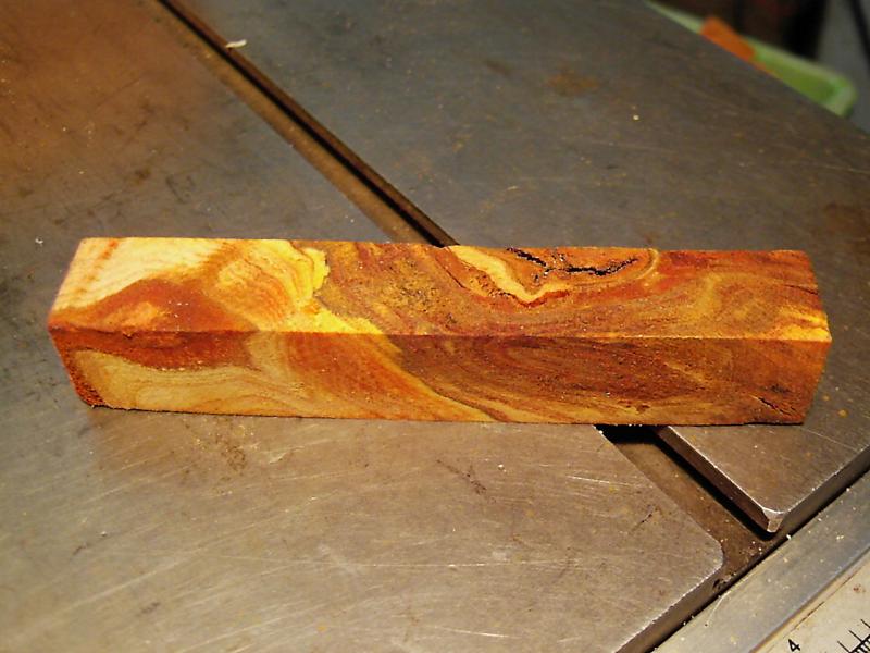

The Almond burled wood are all cut into pen blanks as an attempt to save the unique burled wood, leaving it whole wouldn't work from experience, the best bet is to cut it in the small size possible (slightly oversized pen blanks), soaked them in Fungishield (twice in a 24 hour period), rapped them tight in drying towers, put them a side and pray like hell...!
All the burl colours and texture will change dramatically when dry, if this doesn't work and so that I keep some record of how unique and beautiful these rare burled wood is when green, today I decided to select one of those blanks out from the boxes Merissa is treating with the Fungishield and with already one coat of the treatment from yesterday, I decided to take it to the lathe, turn it round as the normal samples and instead of using my normal sealing + Floorseal finish, which would take at least 3 or 4 days to complete, I used the CA finish to achieve an immediate result for the pics I wanted to take this evening.
I know that this blank will destroy itself from being turned green and wet and force a CA finish on it, for those that tried to get a half decent CA finish on a wet and green piece of wood, will know what I'm talking about, just a nightmare...!
Anyway, I didn't achieve a perfect Ca finish but I'm happy with what I achieved considering. I should have done this during the day to take some better close up pics with some daylight but, these last 2 days we have been having the most rain he had for a long time and the weather channel predicts the same weather for a few more days (1 week...!:eek:) so the chances of sunshine are 'Nill/Ziltch", waiting could be too late so I got it done late this evening and took the sample to the house and took some pics the best I could.
As always, the pics do no justice to this blank, in person is just amazing and I'm enjoying it by keeping it next to my computer to keep an eye on it and see all long things start to "change/deteriorate" so, have a good look at it and enjoy such beauty, I took a pic of each of the four sides, and every single face is special, almost looking artificial...!
I can not and will not guarantee that I will endup with any blanks even close to this one when they all dry, even tough there are a lot of them looking like this one right now, let's hope, fingers cross...!

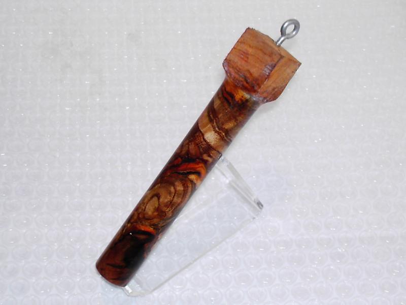

Hi everyone,

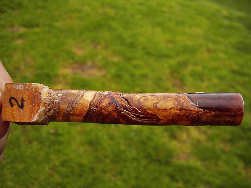

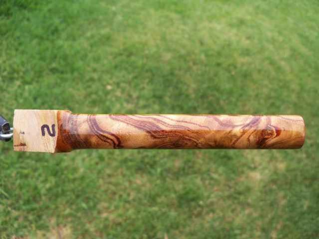

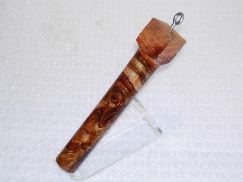

Just a quick update on the almond burl pen blanks and some update on the sample turned green.
The blanks after being soaked twice in Fungishield, stacked and strapped, seem to be doing OK, it has been only 19 days approx, since the wood was processed so, is still a fair way to go...!
The turned sample tough, is doing exactly what I predicted. The thick CA finish is certainly holding things together to a point but, nothing will stop nature to do its thing...!
I had taken pics of the sample 5 days after I turned and coated it with CA, which I though I had already posted them here, I may have posted them elsewhere (yeah, I think I did...!) and forgot to add them here but today, even tough with the sun hiding behind heavy showery clouds for many days, I took a couple of pics of what it looks at present...!
Look closely at the colour changing/blending and how all the white on the original pics is already gone...!:eek::mad:
How much more to go...??? hard to say but, no doubt isn't over yet...!:eek::mad::wink:
PS: The last 2 pics are the current ones as of today (19/9/10)

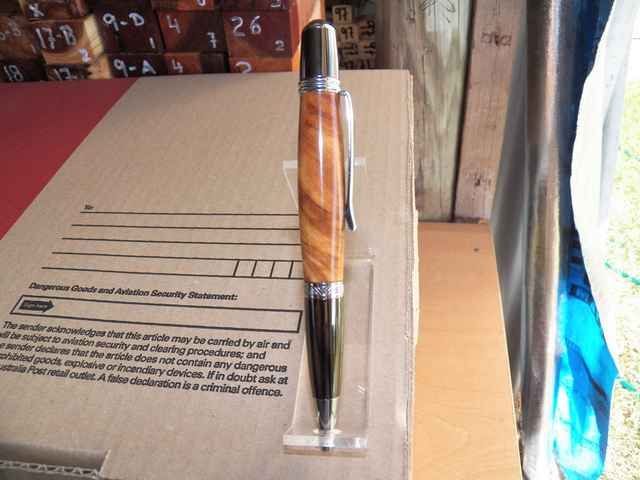

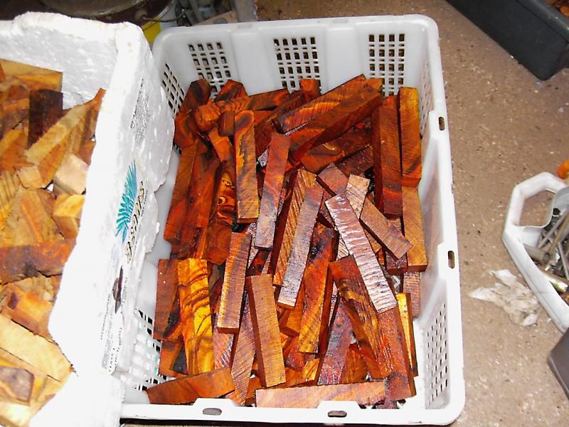

Well, it has been a while since I mention anything about this wood, and while I've taken all the necessary steps to yield as much of usable burled wood after dried, was nothing else I could do since.
In fact, and while I never forgotten them, drying in 2 made drying towers, under the digital scales table, inside my "lolly-shop", I acquired so many different woods since that the piles of "towers" grow like a pyramid as the Almond burl, behind all of that so, and after processing some of these latest woods, was time for me to get those towers from under the table, cut the straps and see what I endup with...!
I could see from the tower outside that was a tremendous amount of shrinkage, warping/twisting and all sorts of crazy things that I was expecting this wood to do, even tough I absolutely soaked it with Fungishield. One tower had the full size blanks the other the shorts, which had some of the best bits of the burled stuff.
Lost a few, due to "blowing" apart, too damn warped, and a few that went very skinny, beyond recoverable pen blank size so, in the end, I didn't do too badly considering. All the usable blanks had to be manually straighten and resized on the bandsaw, which made them under the 21mm square preferred but, at this point and still not yet put trough the sander, they should finish about 19mm or so.

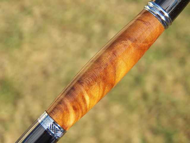

While I was working on these blanks, I remembered that I had promised the old fellow to make something out of his wood and give it to him as a gift so, yesterday and while having some visitors, that wanted some wood, they also wanted to learn how to make a pen so, I used the opportunity to make a demonstration and get the pen that I needed done at the same time, a win win situation...!
The small piece that I selected for this Sierra type pen, was not the must burled stuff, but was part of the burl, showing no crevasses to repair and a nice mix in between a well grained old piece of Almond wood and some burled formations...!
One that is particularly pleasant is the "creek" type line formation in the wood, something that is not too obvious, unless one has good eyesight or very strong glasses but, when zoomed in with the camera, it shows well, what I'm talking about. Just a beautiful piece of wood and I fortunately, have a "fair" bit of it...!
While this piece has simple lines, the very heart of the small burls, is extremely busy and colourful, something that will be more visible as soon as I get them sanded and waxed to protect and enhance the natural colours.
I hope you enjoy it...!

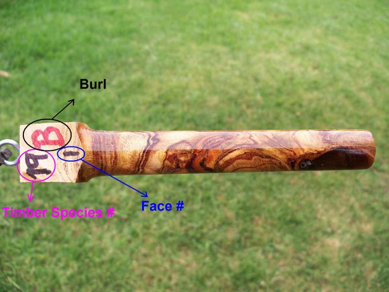

PS: The first 4 pics are from the very same sample I turned in the beginning while green, shown above, and after it dried out or should I say, finished shrivelling up badly. I re-turned it, still big enough to make a pen out of it, if I wanted to, which I don't...!

"Lost a few, due to "blowing" apart, too damn warped, and a few that went very skinny, beyond recoverable pen blank size so, in the end, I didn't do too badly considering. All the usable blanks had to be manually straighten and resized on the bandsaw, which made them under the 21mm square preferred but, at this point and still not yet put trough the sander, they should finish about 19mm or so."
Couldn't these blanks be salvaged by stabalizing and/or casting in PR (worthless wood)? I'll bet there's someone here that would like to try.

Ouch, you got me there...!:eek::redface:
What you don't know, and I should have been more specific, when I said "I lost a few" is that, I didn't really "lose" them as throwing them in the rubbish bin, no...no...no...!
I lost them, as full size wood pen blanks but, they were safely put in a box for the next step of my "salvaging" process, which is, cast them myself as Resifills, which is the name I gave to all my wood and PR casted blanks. Many here have used some of these Resifills and know that isn't much that I can't transform into a pen blank so, nothing goes to wast in here, particularly little *gems" like these...!:wink::biggrin:
So don't worry, all has been taken care of but, thanks for the suggestion...!:smile-big:
