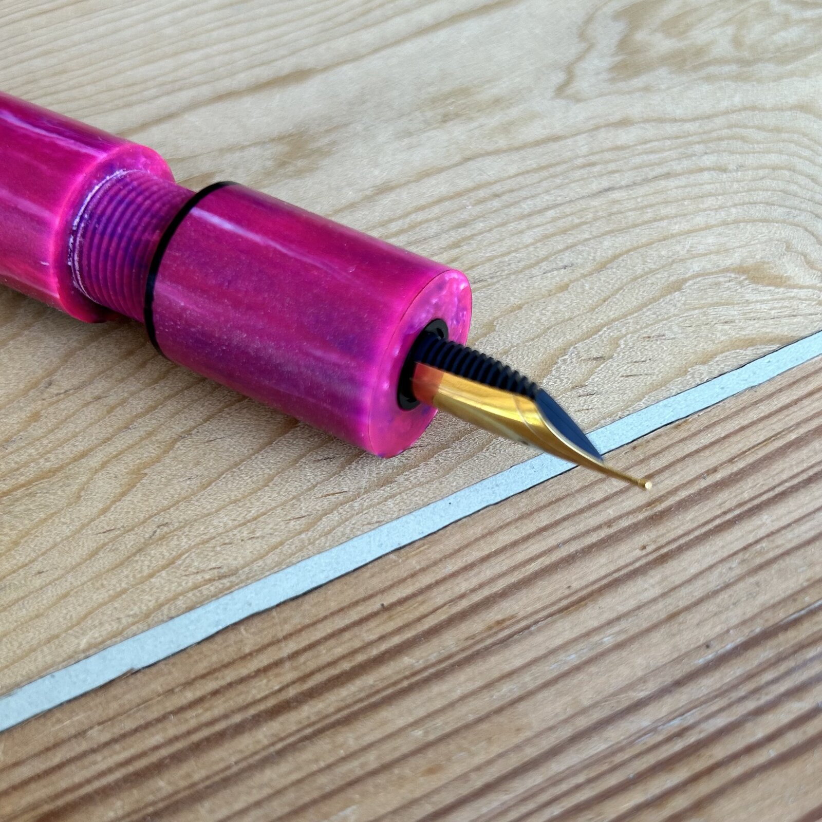

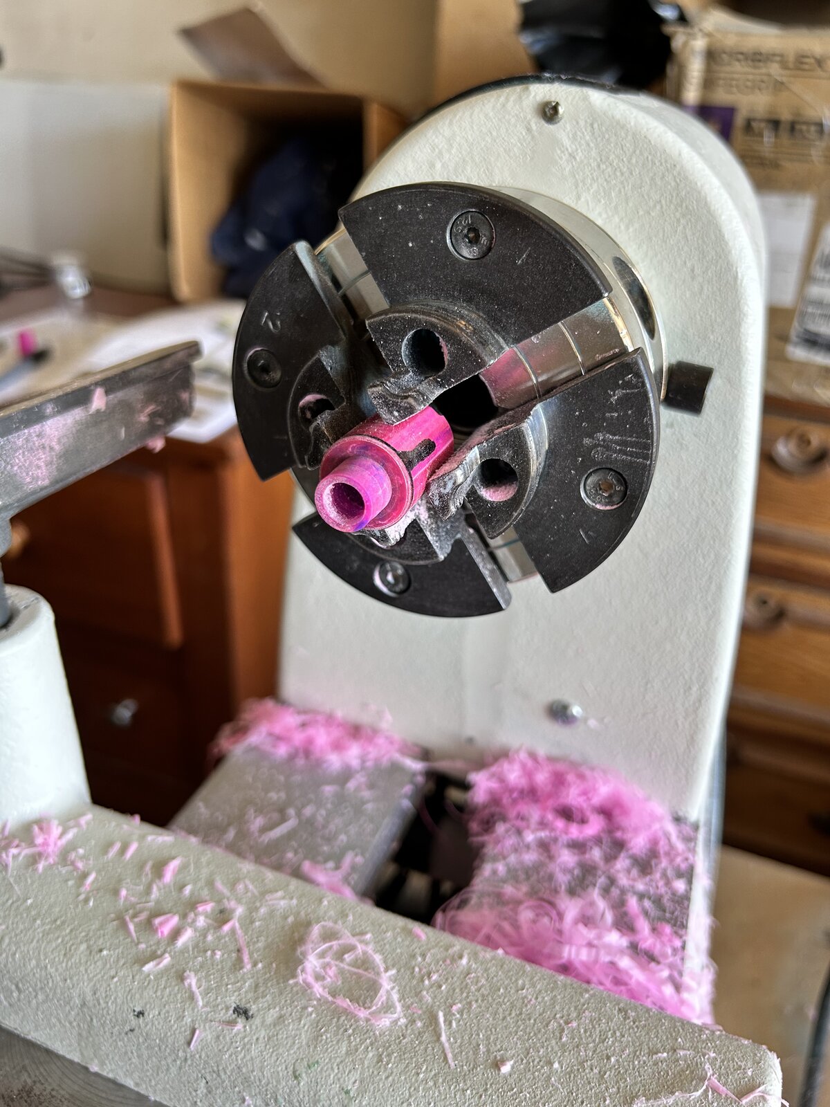

Today we're on to the section, of course we've never made a section before, so it's all new. I cut my first tenon and as you'll see I made it slightly too small, the body and section still go together, next time I'll do better. The nib fits the section well. I think we're going to modify the threads where the cap screws to the body…the threads on the body are so long and it takes a bit to screw on the cap, and there may be a few other minor modifications but over all so far so good.
Warmer in the garage today (we're supposed to be 106) , so only little spurts of work between breaks. 😂

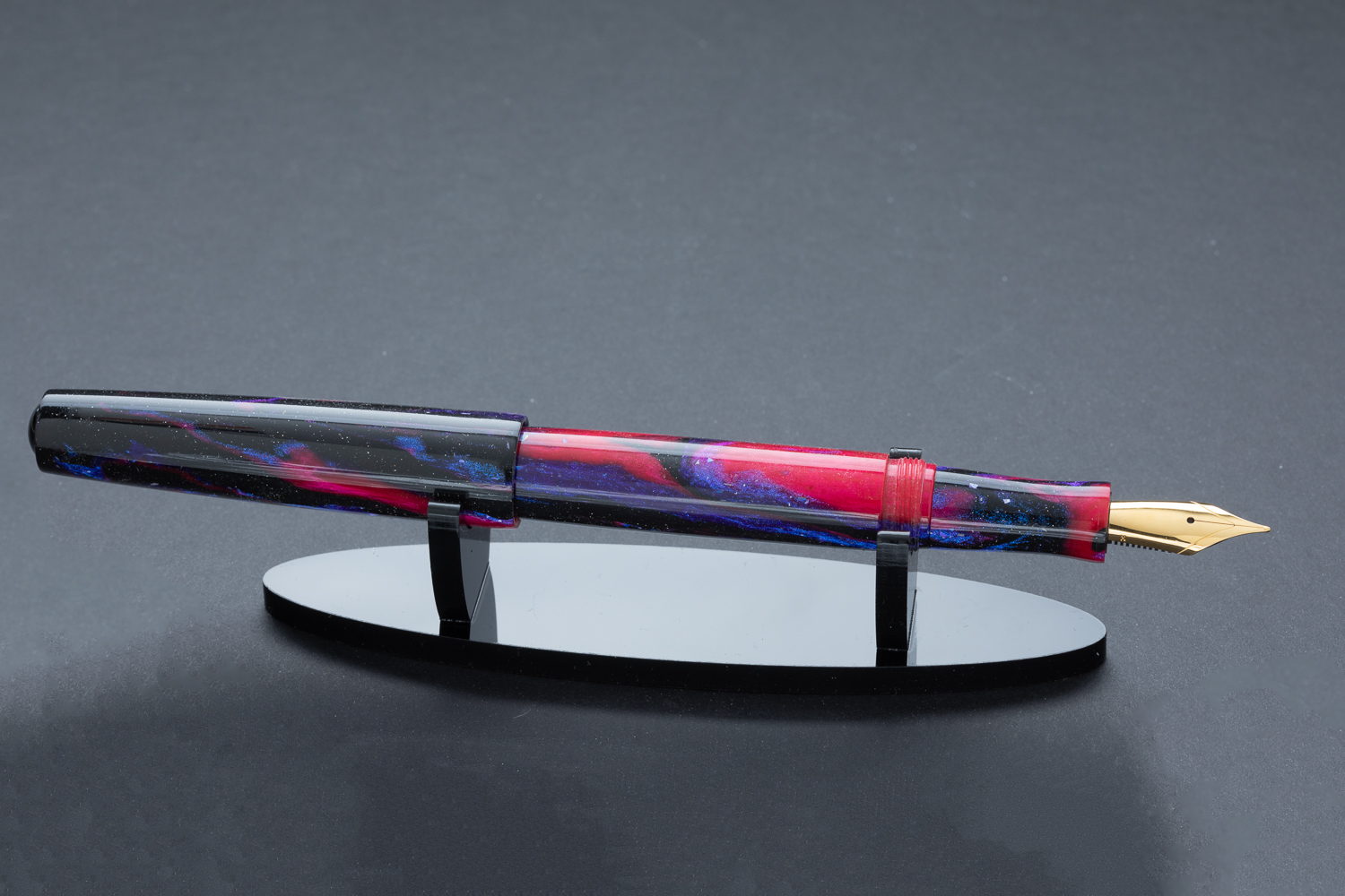

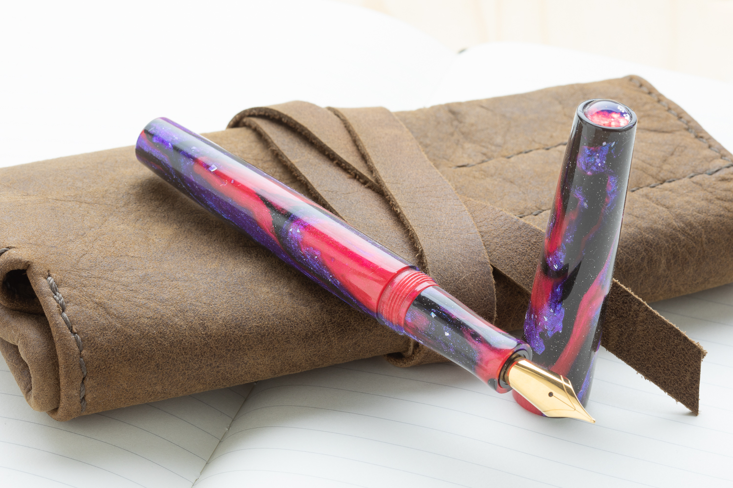

Looks like you've got a good start. This is one I just posted. You can see the shape of the section I tend to make (I use a radius skew as a scraper to make the shape) and you can see where I turned off the threads. I am using M14 x 0.8 triple start threads. With them that short it's between 1 and 1.5 turns to take the cap off. Be gentle turning off the threads and use a REALLY sharp tool and very light cuts so you get no catches. If it catches it'll break. (Again, I use the skew as a scraper for this.)
I hope this helps.
View attachment 358448View attachment 358449
I hope this helps.
Thank you for the tips, you're very generous. This is our first one and we have something's to work on for sure.
