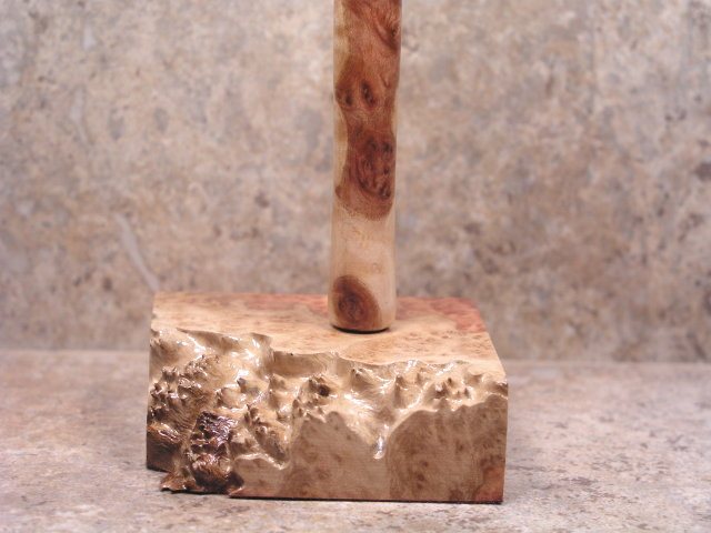

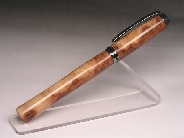

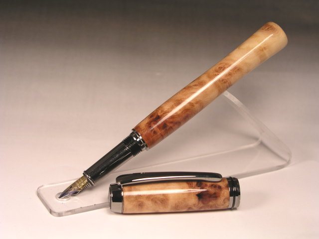

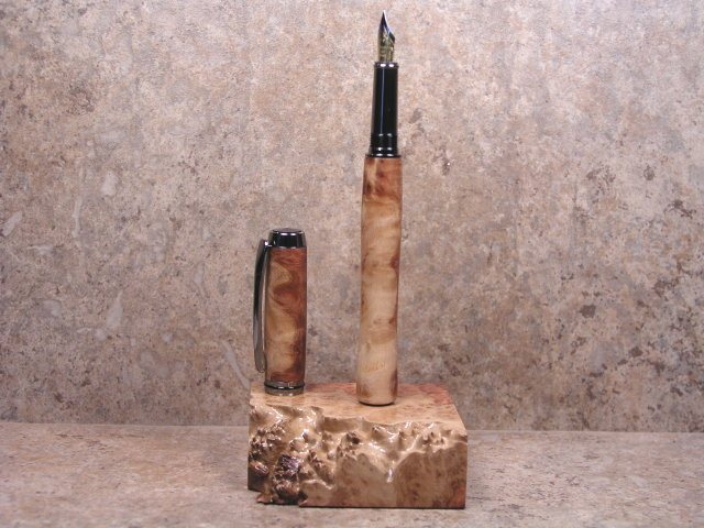

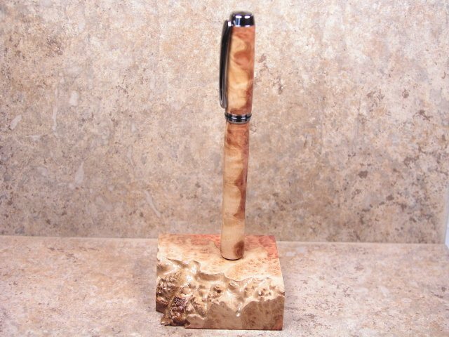

Hello all,
This is a new design that I am working on. This is the prototype that actually came out better than expected for once! Nothing like using a nice burl as a test piece. I do this as it makes me strive harder... ;)
Anyway, this is a Baron closed end in Red Mallee Burl w/ sapwood. I step drilled the interior of the closed end (Way down in there) to accept a strong rare earth magnet. The Red Malle Burl (Natural edged) base also contains a hidden magnet. The Pen rests in the upright position on the stand nicely. I am reworking the base to address something I thought of after the fact. Anyway, thanks for looking. Feel free to ask away.

Now that is very cool!! At first I wondered why the heck you'd want a magnet in your pen, but now I see! It's a beautiful pen, but it looks very sharp on that stand! Did you make the stand too? Where's the magnet in the stand? I know those magnets can be pretty strong, so does the pen want to pull towards anything else? Like do paperclips fly across the desk? [:D]

I presume you drilled a blind hole from the bottom of the stand for the magnet there. Guessing about 1/4 or 3/8 size so the water cooler does not slide across the room to meet the pen base.

The magnetism needs to be quite strong to hold the pen upright (Especially with the cap in place) There were several factors that I considered. I did not want the magnetism to be so strong that the base lifted with the pen when the pen was removed. Too little and the pen would not stand. As it sits now, if the pen is tapped agressively near its cap, it will fall over. But it is fairly secure when in position. I deem it would be acceptable.
The alternatives would be to use a stronger based magnet. I don't like this because of the base lifting issue, though I could drill some holes and fill them with melted led for weight. Next would be to make a flat base on the closed end side of the pen. I didn't want the design of the closed end to suffer.
On the new base that I just finished, I chucked it up on the lathe and scraped out a small bowl for the pen to rest in. A little better.
Ken was correct with the blind hole from the back. The strenght of the pull can be adjusted by how much material is left between the magnet and the outer surface of the pen stand. The base uses a 1/2" cylinder while the pen uses a 1/4" cylinder.
The magnets are not so strong that they attract metal too well. So the fyling paper clips is not an issue [:D]. Also, they are so light, that the closed end weight does not change in the least.

James - This is one of those deals that you look at and say...duh, why didnt I think of that? Very cool idea. Exceptionally done as well. You really do the mallee burls justice. How much material is between the magnet and the end of the pen?

The magnets can really vary, but you will find that really the ones that magnetized axially (In a Cylinder, that is on the top and bottom) the pull on the 1/4" diameters are all around 3-4 lbs (Pull force). Now the 1/2" cylinder (x 3/8" long) that I used for the base around almost 17 lbs. So you are looking at about 20 lbs total. There is about 1/4" (Likely less) of material over each of the magnets, so around 1/2" total between them.
