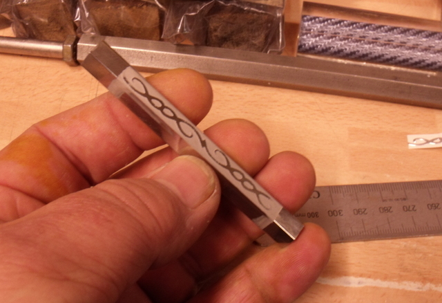

Well Brad, sort of successful, I guess. I'm pleased with the 'process' and the 'finish' is exactly what I was hoping for. My own 'technique' on the other hand needs a lot of tweaking and it can only get better.:rolleyes:
The heater was a dud and so no heat.
This peice was left in the cold solution for about an hour.
I mixed the 2 x 250ml bottles with water to make a litre of juice.
The kiddies craft stickers didn't like the Isopropanal or the hot water and the piece most definitely had fingerprints all over it by the time I re-did it.
The juice leaked under the tape masking. ( probably cos of the fingerprints )
Here is the result of my quick test piece.
So......good result actually. I'm sure if I make more effort to be careful then it will work perfectly.
I'm thinking of trying a different method of masking. What do you think of something like paint or nail varnish as a mask and then remove the stickers before etching?

Thats a good crack for your first go, nicely done. With regards to other masks and things all i can say is give it a try, as i dont want to sit here saying that wont work, and neither will that just because it didnt work for me. I tried something similar to nail polish, though i found it difficult painting over my mask and then removing the mask keeping a neat straight line without the edge of the paint tearing , flaking, stretching etc. I can post you some of my spare vinyl stickers to play with if you like? at least that way you can see and feel what sort of vinyl im referring to. its pretty tough durable stuff ... my honest opinion would be rather than trying to reinvent the mask, rather try a different type of vinyl to find one which works for you... EG the stuff used for sign writing, oppose to stickers sold as decals etc.

I had similar thoughts about the edges staying sharp if I used nail varnish or paint and the fact that you've tried it and moved on, is good enough for me not to bother.
Thanks for the offer of the vinyl, but let me have another go with the stickers again, but this time I'll take much more care with the cleaning etc.:redface:
When you get your own vinyl cutter, I'll be your first customer:biggrin:
Thanks again for the great intoduction to this. :biggrin: I had almost given up on the idea until you showed it works on stainless too.. :wink:

yep plays a key point to stop it getting under the edges as you found out.... though so does the boiling water to in effect shrinkwrap the piece with the plastic vinyl.. if the stickers you have wont hold up to the bopiling water, i suspect you will continue to get the issue you have found.
Watch your patterns too if your only going for getting the pattern ont he piece and not going for depth of the etch you will be fine. if you decide you want to etch to some depth, like 0.25mm+ then you will have to watch your patterns to make sure the lines are not thin. I could see the stickers your using being a PITA. Reason being what you are diong is called Isotropic etching.. which means it etches in all directions, not just down, but sideways too eating its way into the metal what is supporting the mask.
under normal circumstances its fine.. it just means you have a curved wall going on underneith the surface of your pattern like this, and it doesnt cause a problem:
attachment.php
The problem you get, is when there is a thin line and the etchant eats the metal away from both sides!
If the line is too thin, the wall supporting your mask literally dissolves. It doesnt fail because the acid got underneith the mask, its because the ground was eaten away from beneath it.
