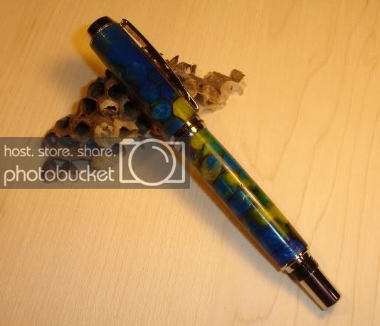

This is one of my bee hive pens. The hive was found in a snowbank on my front lawn under a big cottonwood tree. Wasn't sure about if it needed a finish because the walls of the hive are very thin, maybe the alumilite penetrated and plasticized it, I don't know. I did a single coat of thin CA just in case, to seal the "paper", then pretty much sanded it all off and polished.
Kit is a chrome Baron.

Jeff is there anyway to adjust your white balance or photograph it on a white background??? The color is washed out by the tan wood under it. We can not really appreciate the different colors in the blank. Great idea though.
Sorry, my camera has no white balance. Normally I use white paper under the pen which does probably help a bit, but the shop is extreme in need of cleaning. :biggrin: Lighting out there isn't the best either. I've been so busy out there, and I was planing 60 bf of lumber in the shop so someone could have a good pen display. A new camera is on my list of things I need, because I want to make a photo tent and photo better pictures for my website I've been working on too.

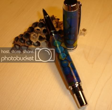

We are all looking around at what we can turn into pens that has got to bee one of the most creative ideas ever I applaud you well done! pretty pen too though I would choose different colours me self, Excellent
So what would be the right colors? I like triple mixing and experimenting with different colors. One person said they think a pearly yellow would be best...what about you?
