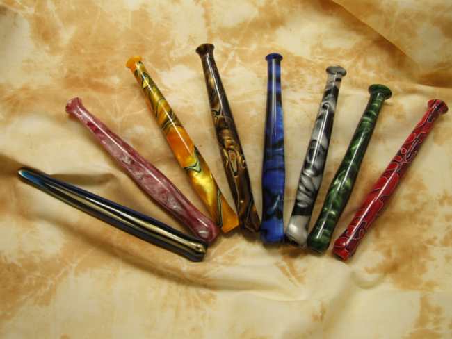

I have an order for more dip pens then I care to make......
Took a photo break, I will be making dip pens all week :)
Thanks for looking [8D]

Anthony, if you don't mind me asking, what's the overall dimensions of the dip pen. I'm assuming it's made from the full length of a blank, but we all KNOW what the first three letters of assume are .....lol.

Those are beautiful, what size hole do you drill for nibs? And is there something inserted to hold the nibs securely?
Yes I want to make one for myself![:p]LOL

Originally posted by ligget
[br what size hole do you drill for nibs? And is there something inserted to hold the nibs securely?
I used a 7mm tube, which holds the nib insert, they are purchased from the UK, here is the link. Almost in your nieghborhood [:D]
http://www.stilesandbates.co.uk/shop/showmproduct.cfm?pid=273

You used a brass tube in them Anthony? I'm in the process of designing a special one right now but thought the nib holder just fit into a 1/4 hole? So the nib holder fits well into a 7mm brass tube? Do you glue it in.
Also, did you use a pin chuck to turn the pen? Also wanted to ask you that same question about the pipe tampers too. Just curious what methods you're using.

Pat, the first ones I made, I used no tube. Now I use a 7mm tube with a pin chuck.
The nib insert fits perfect in the tube, no gluing needed.
On the pipe tampers, I used a gent tube and pin chuck, cut the brass plug on my metal lathe. On the new lucite ones I just made....
http://www.penturners.org/forum/topic.asp?TOPIC_ID=12325#123417
I used a 7mm tube and pin chuck. The only reason I went to the 7mm tube on these, is the transperancy of the lucite.

Is there a benefit to using a tube? Why did you switch?

Two reasons....
It is easier to remove the nib fitting &
My client wanted the tube in as well. What's that saying.....
The customer is allways right [:D]
