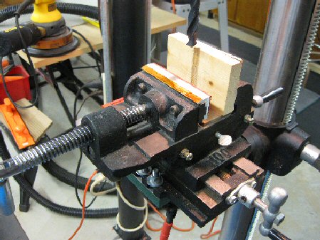

I just received my Gentlemen Jr. II kits from crafts supplies. I was really surprised when they called for a 12.5 mm and 10.5 mm holes.:eek: BTW this is my first of this design. I have what I feel like is a pretty good drilling rig ( See Picture ) but the tube sure did fit loosely after drilling. I used Gorilla glue because I know it expands but I am concerned about the fit.
Am I worrying to much or did I goof up something? My 7 mm and 8 mm tubes always fit very snug.

I'm not sure on that kit but some instructions list the wrong size bit. The best thing is to use calipers to measure the diameter of the tube to determine the proper bit.

I should mention, if you are having any out of round problems - FIX THEM before you turn the cap blank. It's easy to peel off enough material to expose the tube.

You will find that the fit on various kits vary. a to tight of a fit can actually be more of a problem than to loose for reasons I will not go into. loose but not to loose is fine. what to loose is will be something you will come to a feel for as you do more and more kits.

I use a 12.5 and a Z, on all of my series II Juniors I don't own a 10.5, I really don't think the .0004 under size makes much difference.

Don; The hole size may vary with drilling speed and material. With the same drill bit, the hole in acrylic will be slightly larger and wood will be slightly smaller. When I first get a new pen style, I always drill a slightly smaller hole than called for, and then without removing the blank from the vise, try the brass tube and re-drill if necessary. I have a 115 piece drill set and write down the drill size on the instruction sheet for the pen.

Thanks for the feedback everyone. I guess that I just was not careful enough and got a little wobble action going when I drilled that large of a hole. I shall see how it turns as soon as I can get out to the shop.
