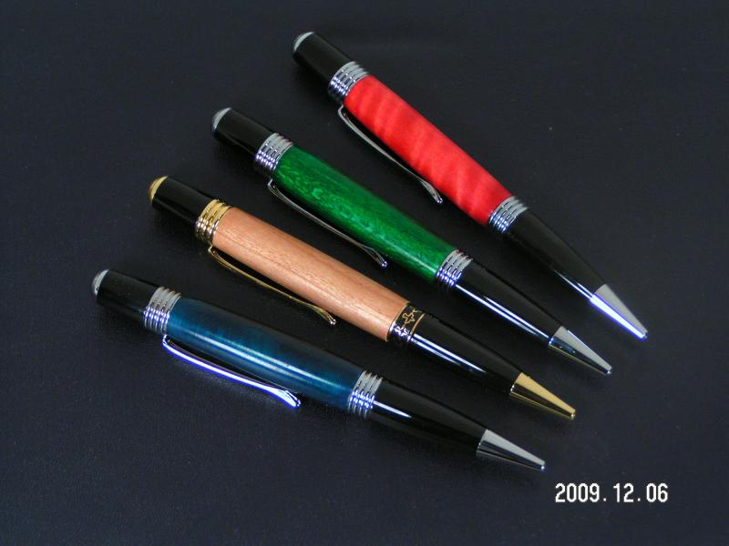

I thought I'd share some photos of what I learned at our first meeting. I'm satisfied with the results but think I can improve.
First one I is sycamore dyed blue. It came out much darker than I wanted. The finish is pretty good but I'll work on that also.
The second one is cherry. I did this for my neighbor, since he gave me some leftovers from a remodel job. I didn't take it down far enough on the nib end of the blank so I'll probably take it apart and fix it.
The green one is also sycamore. I decided to dilute the dye 50/50. I like the color and the finish came out very good.
The red one is the one Tom gave me. It has the best finish and character.
The next ones I do I will dilute the dyes. I can always do darker. Somewhere I have some curly maple but couldn't find it so I went with sycamore. The grain is too small but it is still sort of interesting.
Comments/critiques welcome.

Looking good. I've been busy trying all this stuff as well. Hopefully get some pics up tommorrow. I didn't think about diluting, but will try it the next one I do. You're finish looks really good as well. Just goes to show you, no matter how much you read, just needed someone to show us the tricks.

Those are looking good, I haven't tried diluting the coloring either but sometimes I wipe it away quicker to leave the wood lighter, also you might want to try putting a sanding sealer on the wood before applying the coloring, that will prevent it from soaking in so much. Harder wood equals less absorption. Figured red oak works pretty good if you just want some tinting instead of a bright color.

I'd of never thought of sanding sealer. The sycamore is softer than most woods I have and I know it absorbs more. I'll have to try it tomorrow. I dyed an orange one yesterday that looks good but the finish is bumpy. More sanding and more CA.
