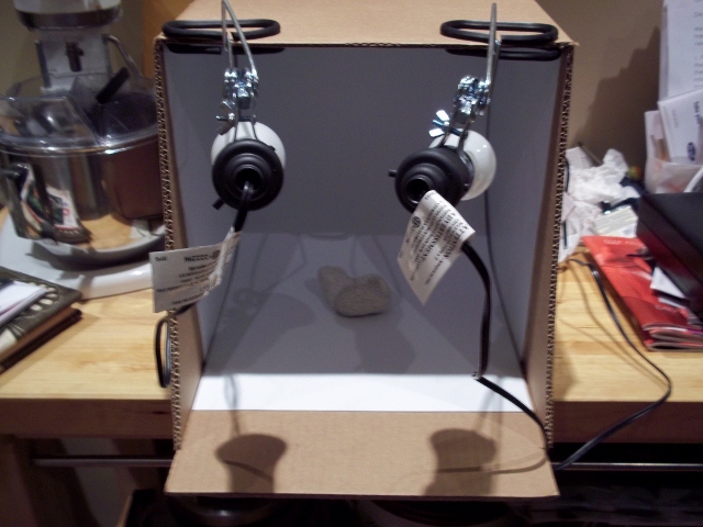

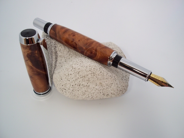

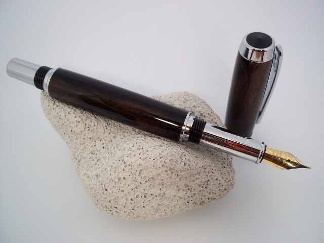

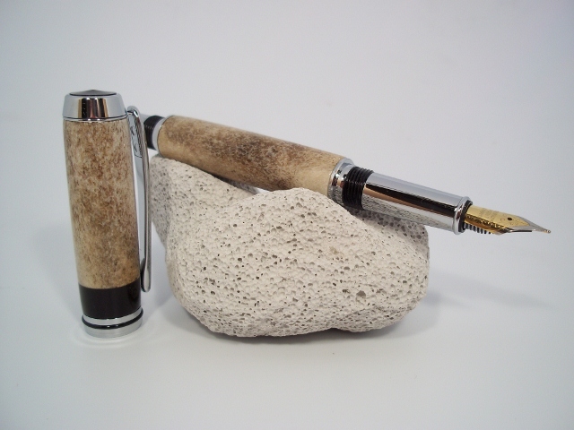

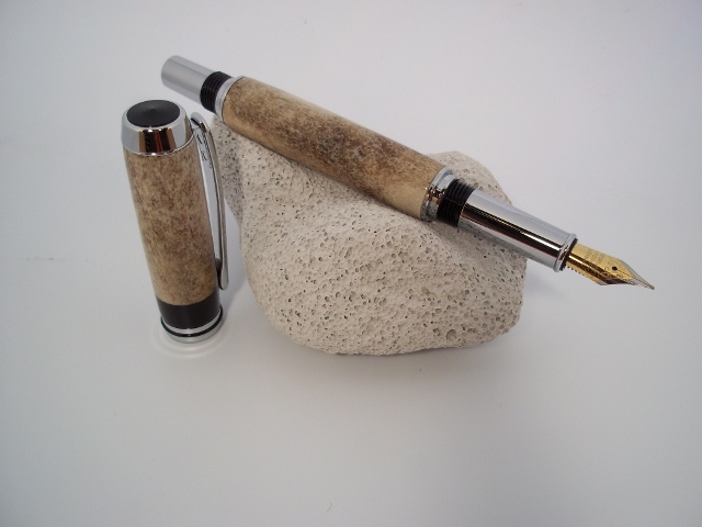

to all those that posted photos and info on light boxes i have to say thank you. i finally got around to making one and shot a few tonight and am very happy with the results. i picked a few of the ideas that i saw and tweeked them as needed. here are some of the results. these are un-touched photos.

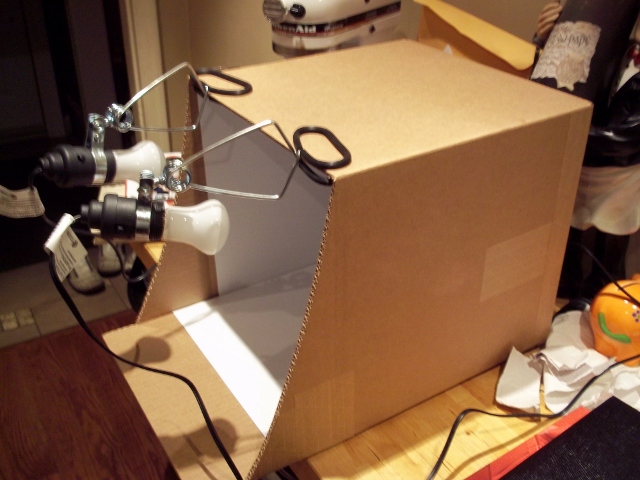

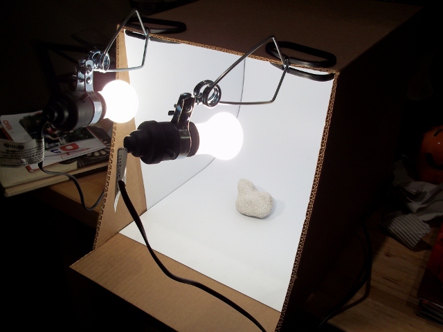

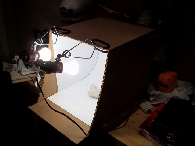

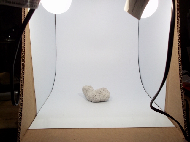

the camera is really nothing fancy. its a kodak easy share m530. really just a digital point and shoot. i do have an dslr but don't haul it out for this although i might now that i have the box. the big key is lots of light, a tripod, and a timer, even just a few seconds is enough to take your hand off the camera.
the box is nothing fancy either but now that i have had a chance to try it i might make another out of plywood. (maybe)

Nice photos and it looks like you came up with a workable box to take your photos in. You may not need to make yourself a plywood box, but I would recommend placing a of 1/4" plywood on top to clamp your light to, because the cardboard won't hold up forever clamp-on lights hanging out like that.
Great box and thanks for sharing it with everyone!
