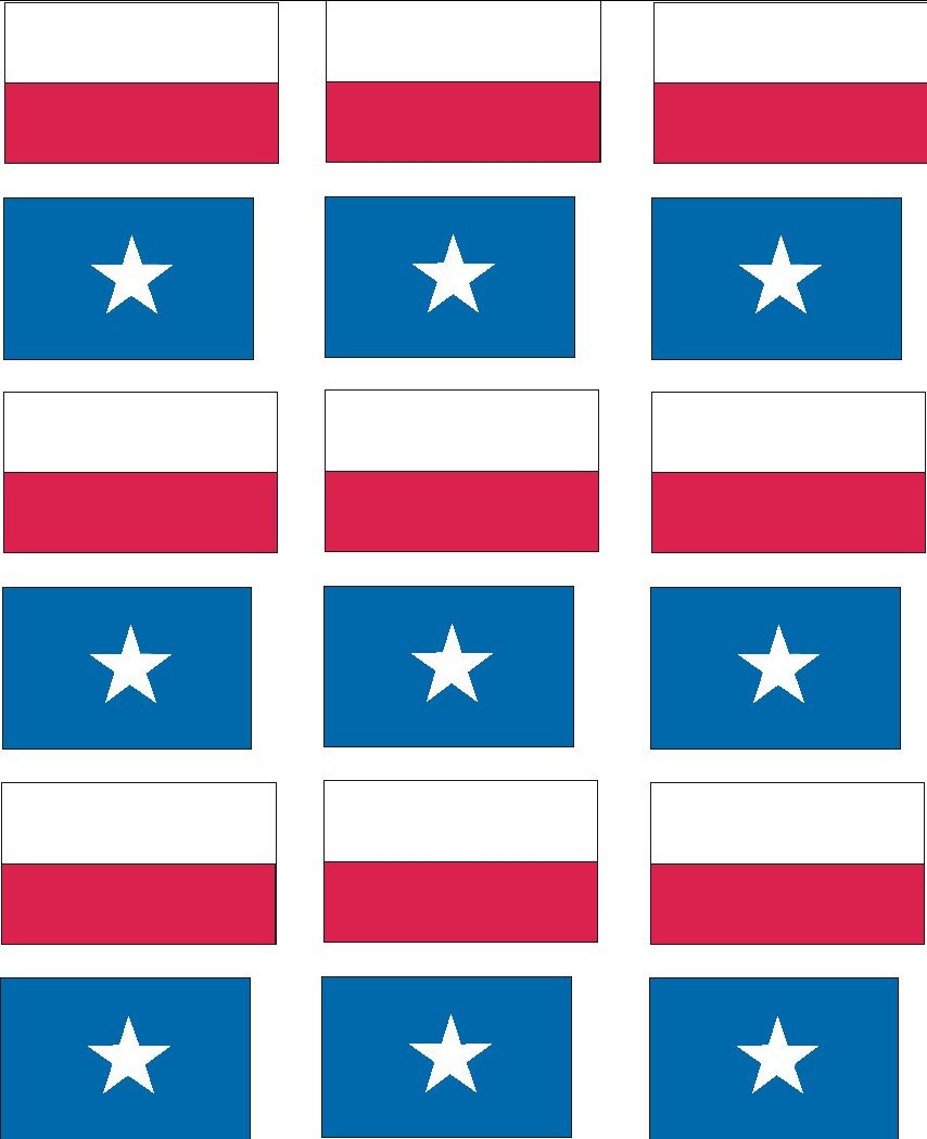

After seeing the USA flag cigar pen, someone asked if I could make a set of Texas Flag cut-outs for the cigar as well. This is a link to the Corel Draw file: http://yoyospin.com/pic8/TexFlag_1.cdr. And here's a picture file:

BTW, I'm not sure that these picture files will translate properly and give you the correct size cut-outs.
Remember your high school math? Diameter x pi = circumference...you could mic a pair of cigar pen tubes and apply this equation to get the answer :), but here's a shortcut:..the flag drawings should measure as follows:
Lower cigar barrel: 2 1/8" x 1 1/4"
Upper cigar barrel: 1 15/16" X 1 1/4"

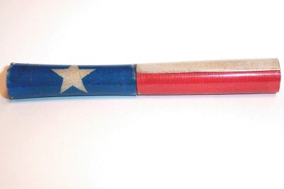

Cast and turned one round (didn't finish it btw!) Just to see if I could do it! It worked, so now I have to do one that is pen worthy. Thanks Ed!!!!!!!!

Ed, I hope you don't mind, but I noticed that some of the stars had some blue lines in them... I removed them and reposted the image here...
