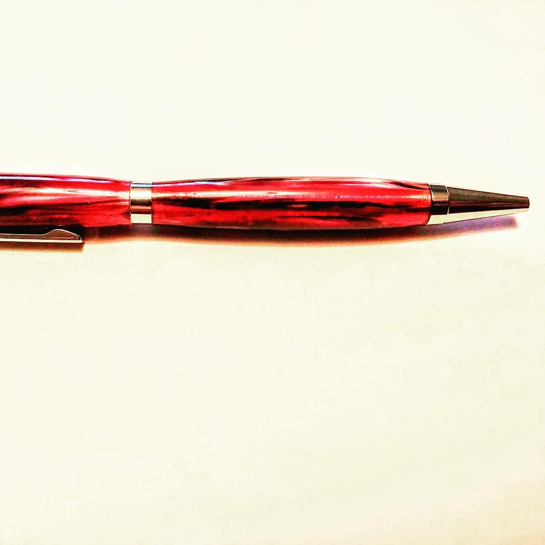

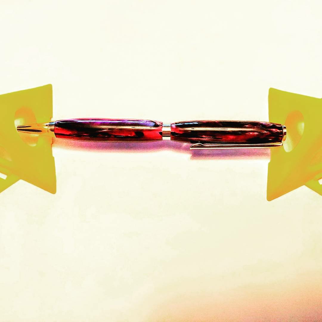

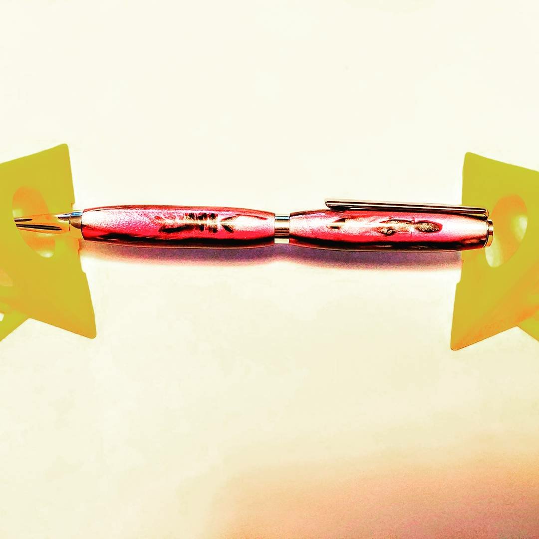

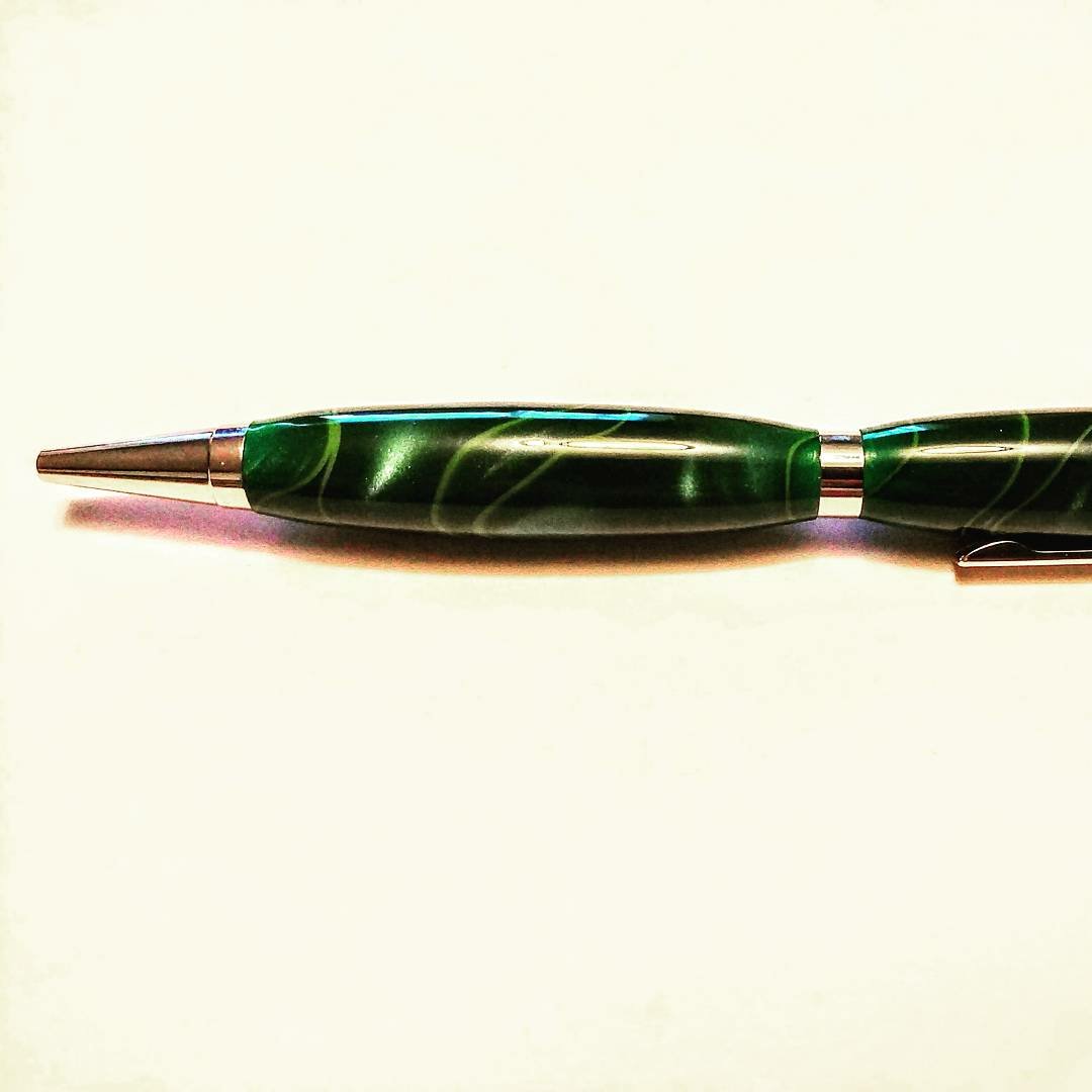

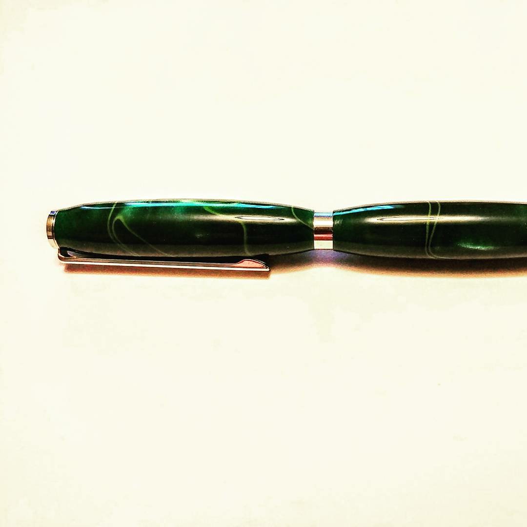

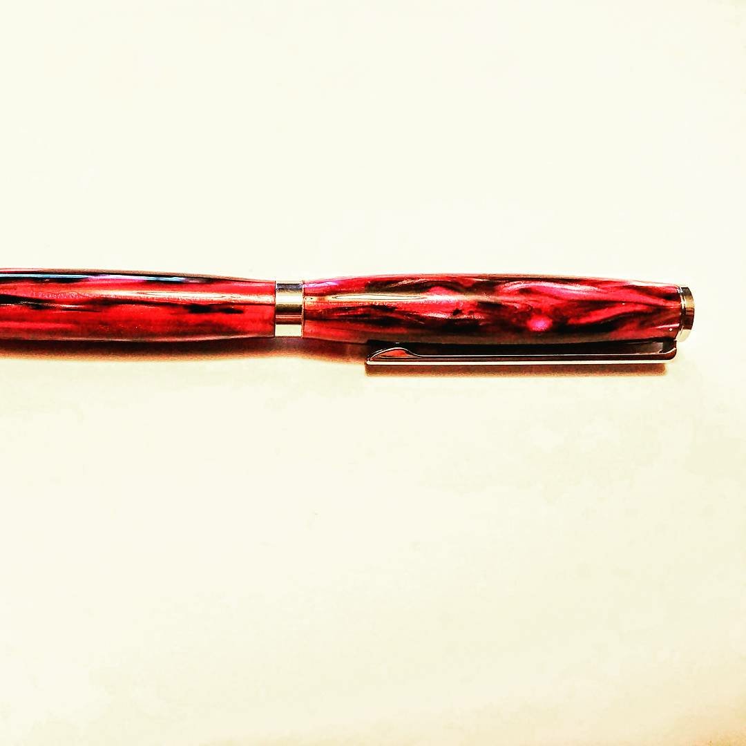

I had better success yesterday turning these pens. I took the advice of sanding the blanks flush with the tubes on my disc sander and taking very light cuts once I got close to the bushings. I used a scraper near the edges to get it flush with the bushings and a spindle gouge on the main part of the blank. I finished it off with a skew scraping it lightly. I tried using carbide but got a lot of chatter. I noticed that when it started to chatter when I was cutting it was more apt to chip. My speed was at the highest speed.
