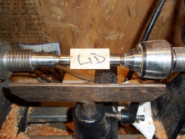

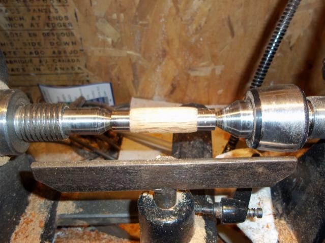

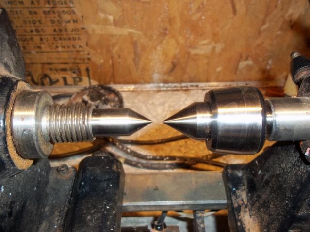

paintspill
Apr 17, 2011
891
toronto, ontario, canada.
here's what your basic set up will look like, not a lot of extra money invested, especially when you consider you can try a new kit to see if you like it without buying the bushings if you don't want to.
the pictures so the blank before and after using the bushings then mounted without the bushings for finishing, i just converted recently and love it
