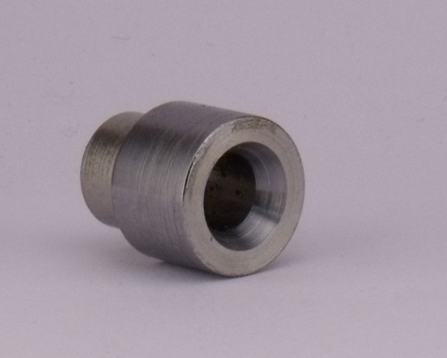

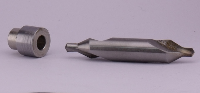

I saw on the latest tutorial someone mentions about drilling their bushings using a 60 degree bit? Not sure if they just call it that or if there is actually one that size? Other than that I am kind of excited to give this a shot.
If you buy one big centre drill you can do all your bushes.
Below are before and after pics of an old bushing. The first pic shows that there is an edge which isn't great to use on a 60 deg centre. The second pic shows that there is now a much larger surface to help keep the bush aligned. You also now need less pressure from the tailstock to clamp the bush/blank/bush assembly.:wink: Hope this helps:biggrin:
Skippy beat me...
Todd; Usually called a combined drill and countersink, these things come in a set of 4 and are fairly cheap. Notice they are double ended? You can find them at many outlets that have metal working tools. 60 degree are common, but you can get them in 82 and 90 degree countersink angles. I have started making my own TBC bushings. I have a metal lathe, mill, and band saw. Tool junkie!
This will drill a hole and the 60 degree countersink
http://www.grizzly.com/products/H5930
Try to find ones from India; they seem to have a higher quality. Name brand counts too but you will pay a lot more!
This one will not drill, only ream and is used to clean up the bore.
http://www.grizzly.com/products/Center-Reamer-HSS-3-pc-Set-60-186-/H2946
You have to be able to accurately mount and center the bushing for drilling. The more accurate your lathe, the better the bushing.
Oh; A LESSON I LEARNED; Put a drop of oil on the tip of the drill bit and drill and countersink run at about 1,000 RPM. If you don't the tip of the drill tends to break off and ruin the piece you are working on. DAMHIKT!
Ream at slow speed.
