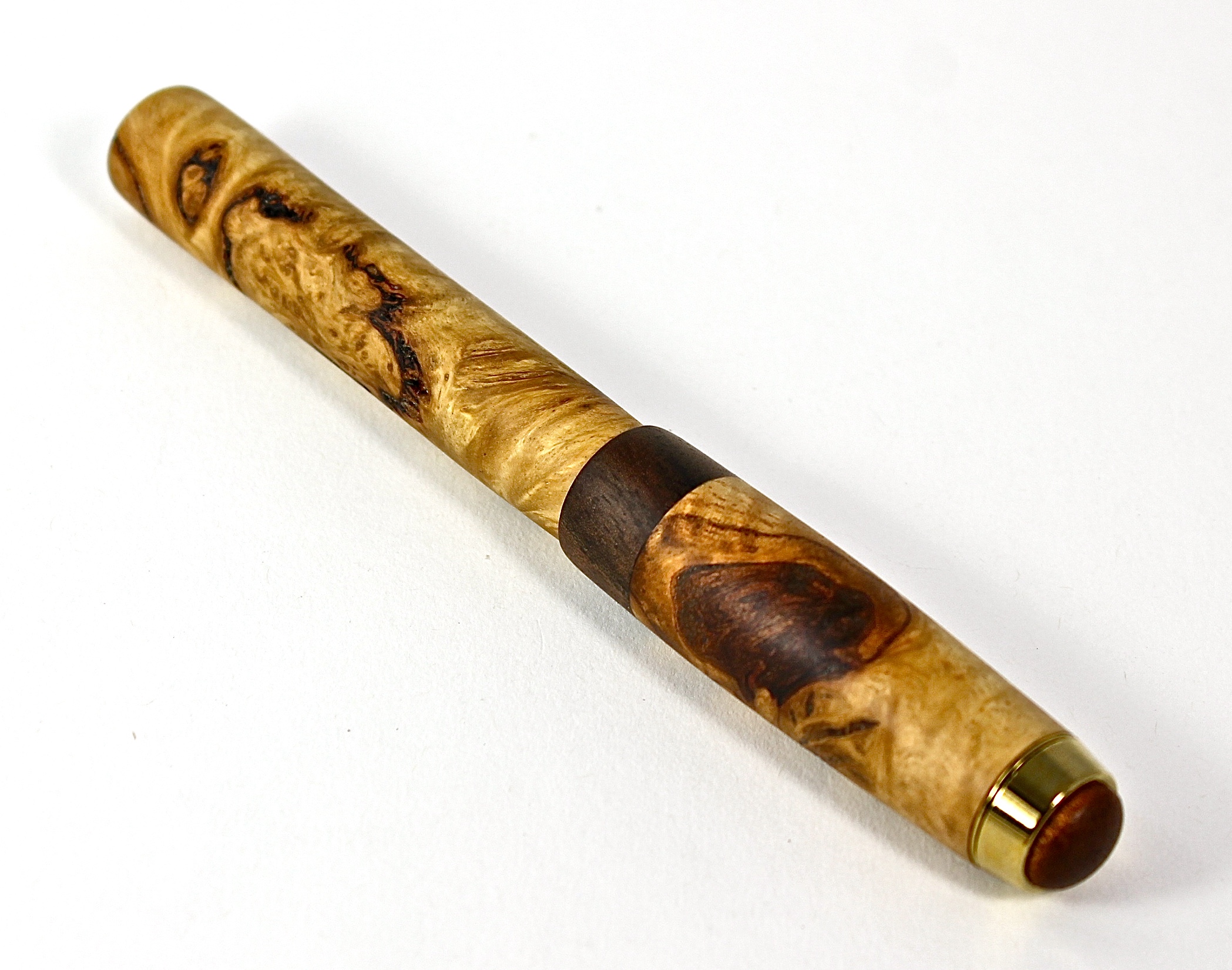

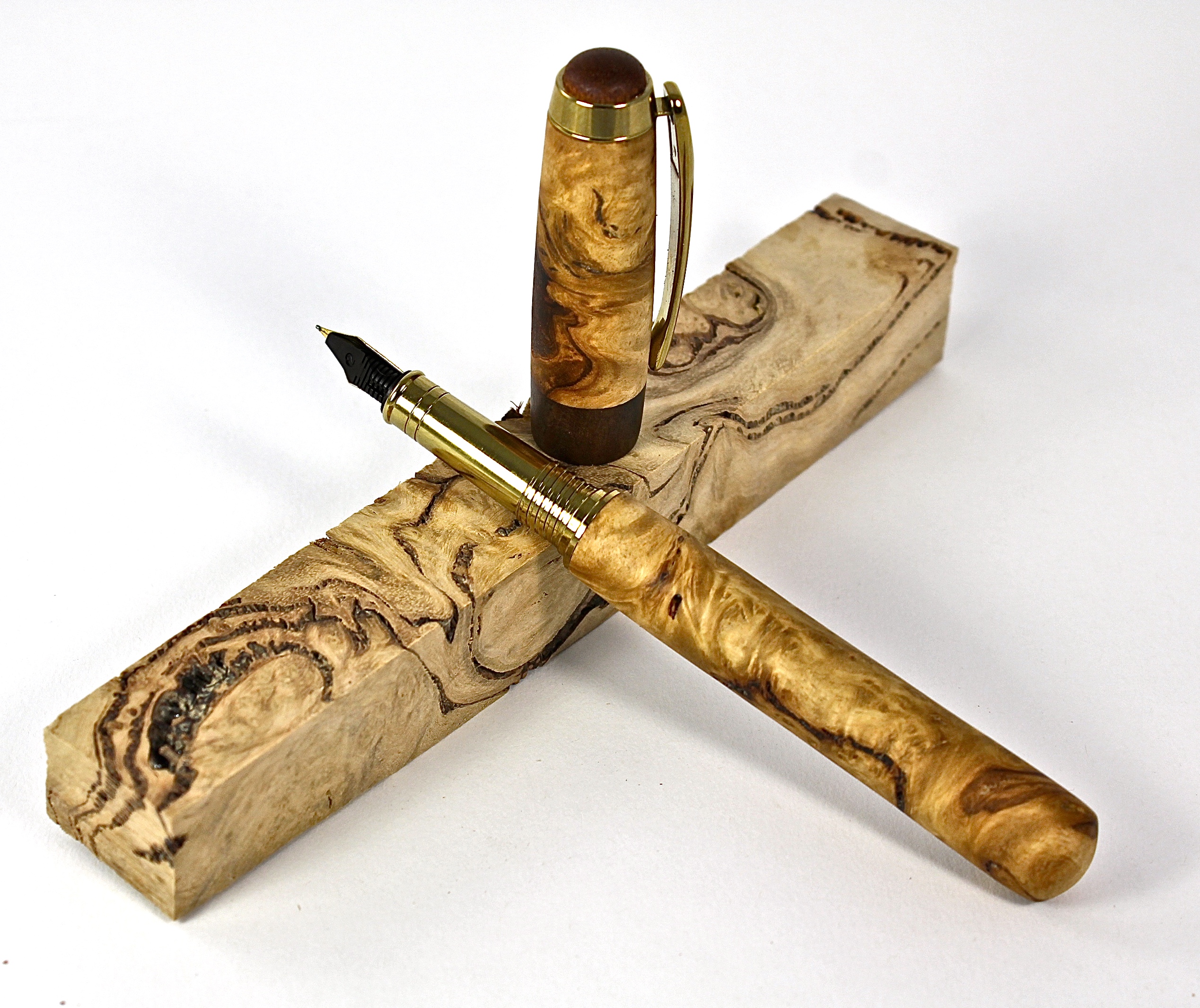

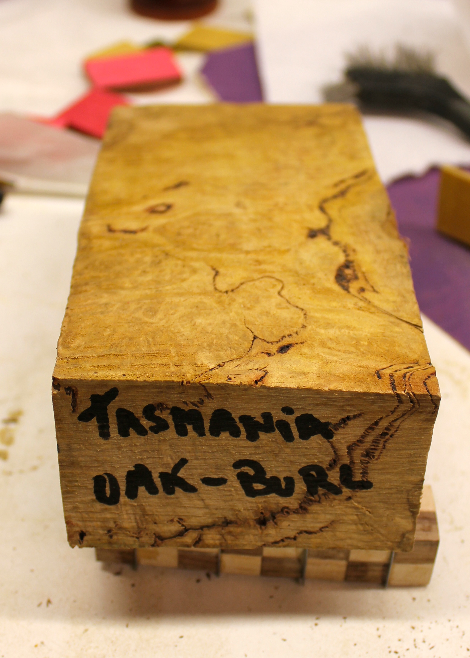

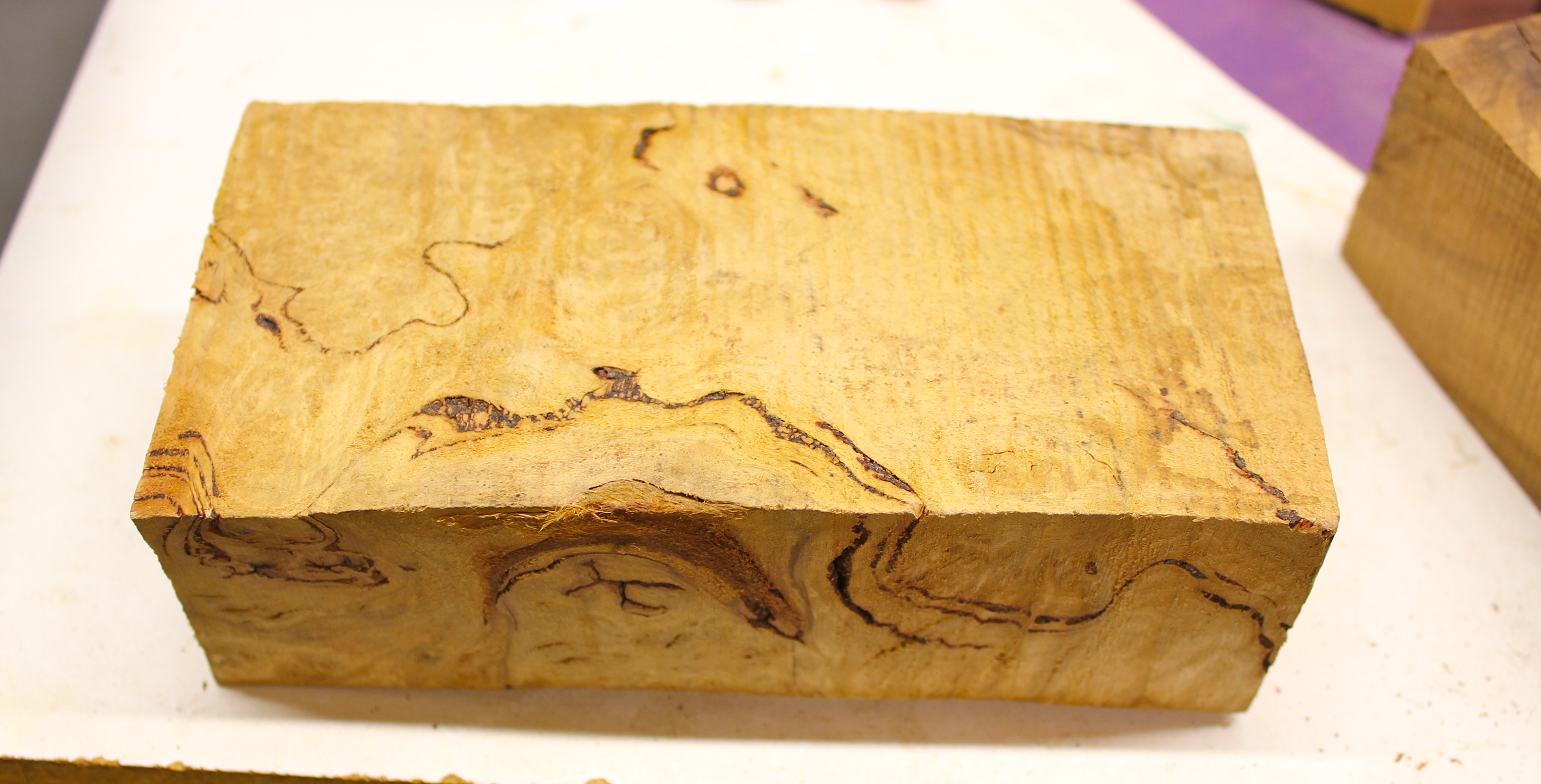

Both Barrels are from a block George (Robutacion) sent me for a Christmas Exchange last year.
Upper/Lower Barrel: Tasmanian Eucalyptus Burl
Center Band/Finial: Claro Walnut from the shop floor...
Recently, I'm going "minimalistic" on my finishes... So, Dry sanded with Abrantet 240, Wet sanded with Abranet/Walnut Oil 320, 400, 600. 3 coats of Danish Oil over 24 hrs. A very dull, matte finish, very smooth, with open inclusions.

Wow Mark your skills are defently getting much better, very nice pen.
Mike
Gee thanks Mike... So last year I stunk (ha ha - just kidding). After I did 5-6 of the closed end pens, I did a basic 2 barrel Atrax... OMG - that was easy!

I finally see a pen made from that Tassie Oak-burl and, what an example that is...!:eek::biggrin:
That wood is just asking for the natural processes in the finish you gave it, all those crystallized gum veins do give it a different looking.
They could be finished with a deep/gloss CA finish also, just a totally different look and feel to the pen wood surface so, either option works well...!
You are definitely doing great work, congrats...!:wink:
