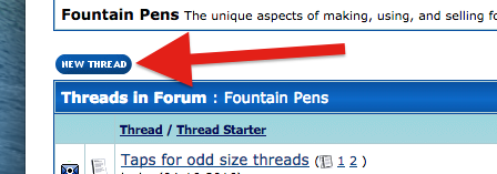

Can someone please show me how to post a new topic. I can't figure out How!
King11
Every forum has a button like this one --
