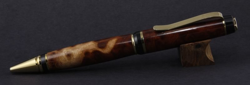

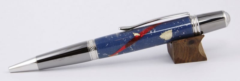

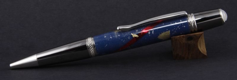

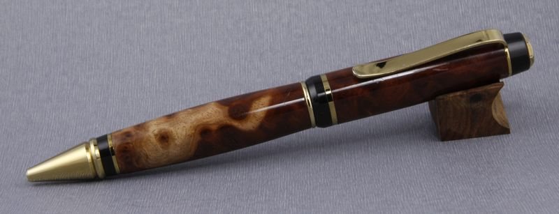

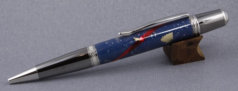

OK, I felt like playing. Here is two pens each taken with three backgrounds: white photo copy paper, "neutral" grey, black construction paper. I started by setting the camera for custom white balance based on the grey card and manually configured it to be proper for the grey card. Each photo is taken with exactly the same settings: ASA200, F20, 1/8 second, with the lens zoomed to 70.
The lighting is exactly the same but the pens look different as you eyes battle the different backgrounds. (and there is probably a little difference from reflected light but it shouldn't be much.)

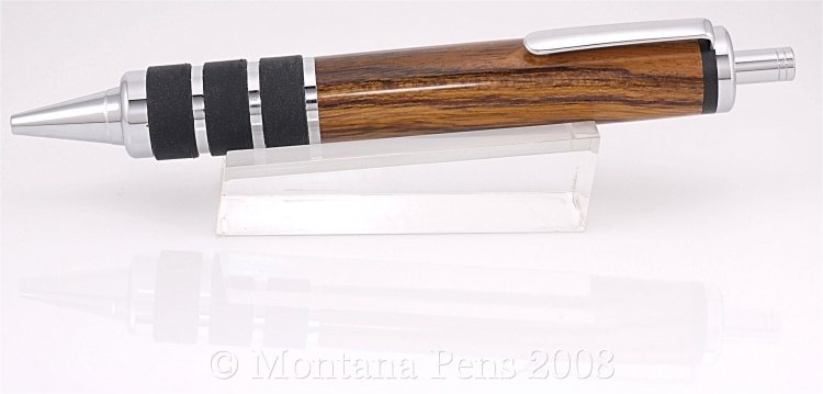

I use a white plexiglass background for virtually all my pen photos. I think it's a matter getting used to dealing with it and remembering the settings.

gerry, is that a clear sheet of plexi with a white paper of some sort beneath it or actual white plexi?

great example of getting a picture of your subject (the pen) as gerry points out set teh exposure (settings) for your subject the pen. notice how much the back ground suffers because of this. imagine if had wanted some white roses int he back ground. it would have been very difficult to get a picture that showed both the pen and the roses well. in this photo the back gtound was obviously not given much consideration at all. the focus set up and intention was to get a good photo of the pen.
