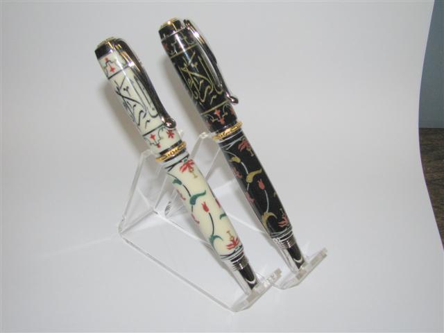

The Taj Mahal really exists. But there was a plan to build a "black Taj" as well ---- never materialized.
After the cost of the Taj Mahal nearly bankrupt the public coffers, the people rebelled and the black Taj was never started. That doesn't mean we can't make pens as a "tribute" to the idea.
So, here is the "Black Taj", to join the small Taj we have shown before.
DAWN (PR_Princess) and Ed

This has evolved.
The original "small Taj" was laser cut (by Ken) then hand-painted (by Dawn). When I finished them, I put a CA coating on to level the pen. I was not happy putting CA on a resin (YES, lots of people do it, doesn't mean I have to LIKE it).
So, we now do it the harder way. The pieces are laser cut a little deeper and Dawn fills with crushed gemstones (on the white) and crushed metals (on the black). I then turn off the "overfill" and she fills again. We keep this up until it is smooth and the pen is then buffed. There is NO top coat, which is MY preference for resin pens. It is merely buffed to a high shine.
Several nights labor in each of these. BUT, fun. And a great sense of achievement when it is finally complete.
Again, the design is Dawn's original artwork. Top half of pen is a quote from the Koran, which actually appears in the Taj Mahal. Bottom half is similar to patterns in the Taj.
When marketed, there is a box and informational brochure that goes along with the pen.

But I did take a quick snap of the Black Taj this morning. Sorry, I am still trying to learn how to take a photo :mad:, but hopefully this will be enough show the metals (copper, brass, ali, and bronze) a little better...They do add just a little bit of sparkle.
