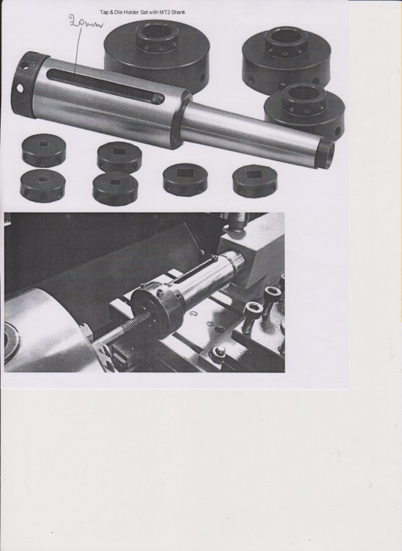

PenPal
Nov 29, 2006
2,708
Canberra, A.C.T., Australia.
Bought this one on the net complete help.
Peter.
