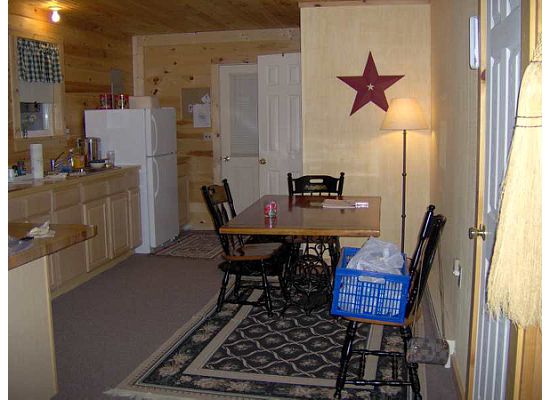

That's a project i have done when i first started woodworking at about 26 years old. The chairs i bought from naked furniture and i finished them in the Hitchcock theme. The set is still being used at my cabin in the mountains after 41 years. The top is solid cherry that i bought from a mill for $6.00 back then. You will enjoy what you will make and receive many good comments.
