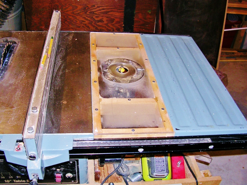

Sherman; I have a Delta contractor saw. I have built a frame out of pine to fill the gap between the saw table and the outer table. Covered it with clear Lexon, drilled mounting holes and a bit clearance hole, and mounted one of my plunge routers to it. The clear plastic makes it easy to see through when turning on/off, changing bits, or making adjustments. Three screws allow you to remove the router if you need to use it for some other task. Cost to make ZERO. Just used scraps that were sitting around the shop

Sherman: Here is a photo of that addition. When not needed, just release the plunge lever and it drops below the table top. And no !! My table saw table is not rusty. I Think it is reflectiog the piece of plywood standing behind it. Jim S

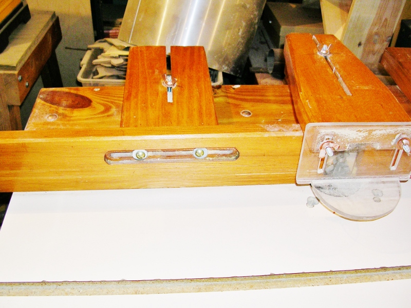

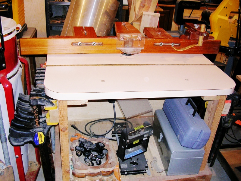

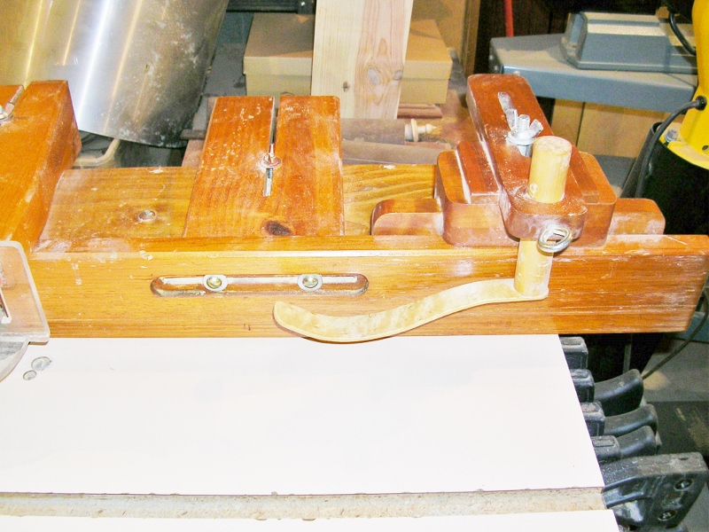

This is the set up I use when I need to make moldings or larger cuts with the router. I made this out of 2 X 4 and 2 X 6 lumber. Fences are independently adjustable as is everything else including the hold down, vacuum lines, and clear plastic guards. Three horsepower VS plunge router mounted under the table that will handle large cutters. Jim S
