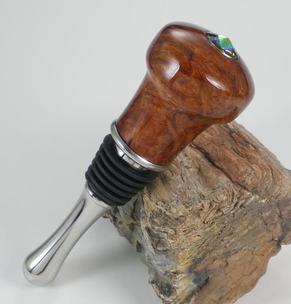

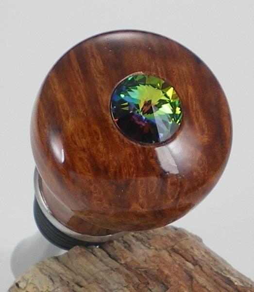

I have used these on bottle stoppers. So far my technique has been to create a cone shaped hole with my carbide tool then fine tune it using my skew as a scraper (I'm a bit limited on tools at this point). I attach the "gem" with a dab of epoxy being careful about squeeze-out on the finished part. Here is a shot of one of my earlier attempts.
