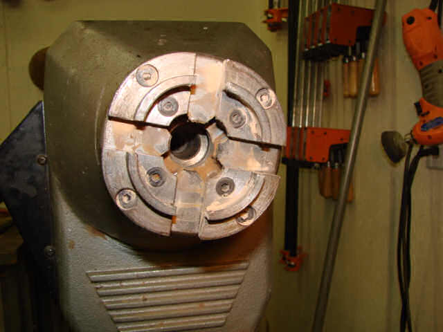

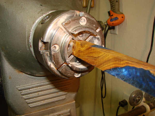

Your current chuck should work. I have a Supernova II and I use mine all the time with the standard jaws it comes with. Here's how:
Mark the center of your blank and then open the jaws on your chuck as far as the will go. Insert the blank in between the jaw centers and lightly tighten them up. Now bring up your drill bit and center the mark on the end of the blank with your bit and tighten the jaws nice and tight. Drill away! Here are a couple of pics to better illustrate.

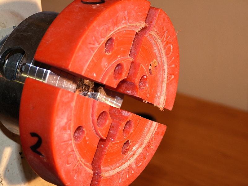

I do just what Curtis said (and showed) with the exception that I bought a
set of 'soft jaws' for the chuck. I think they were about $15.
It's a set of nylon jaws, and you cut them to your own preferred size with
a skew or a scraper while turning. So you turn your own jaws. Doesn't matter
how, because you're actually going IN BETWEEN the jaws, using the inside
edge of the jaw to help keep the blank aligned. I just like the soft jaws for
this because the regular jaws can mark up a blank. (even though you'll turn
that part away later..) The soft jaws are a little deeper, too (perhaps 1") so
it gives you more stability.
ok, so the real reason is that I'm lazy. I just haven't taken the jaws off :biggrin:
Here's a pic of the soft jaws as I was just starting to cut them.

The only thing I do with the soft jaws and blanks is drill them, so the hands
are nowhere near the jaws anyway. And nowhere near that fast. I drill
s . l . o . w
I think I got them at Woodcraft or Rockler .. one of those places. It's an
add-on accessory for Nova chucks, but I'll bet you could make it work on
something else.. they're made to cut, so as long as you can find a way
to line up the screws you should be able to do something with it.
